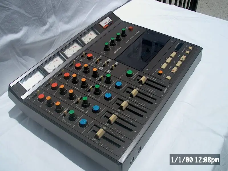

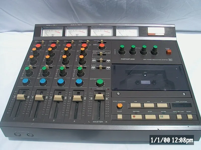

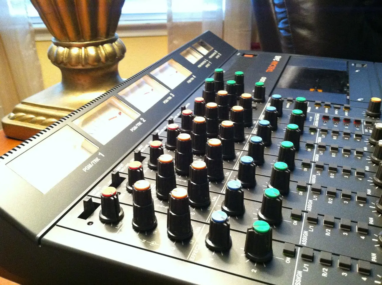

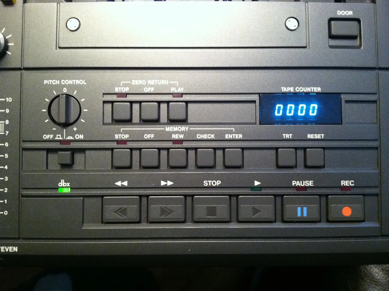

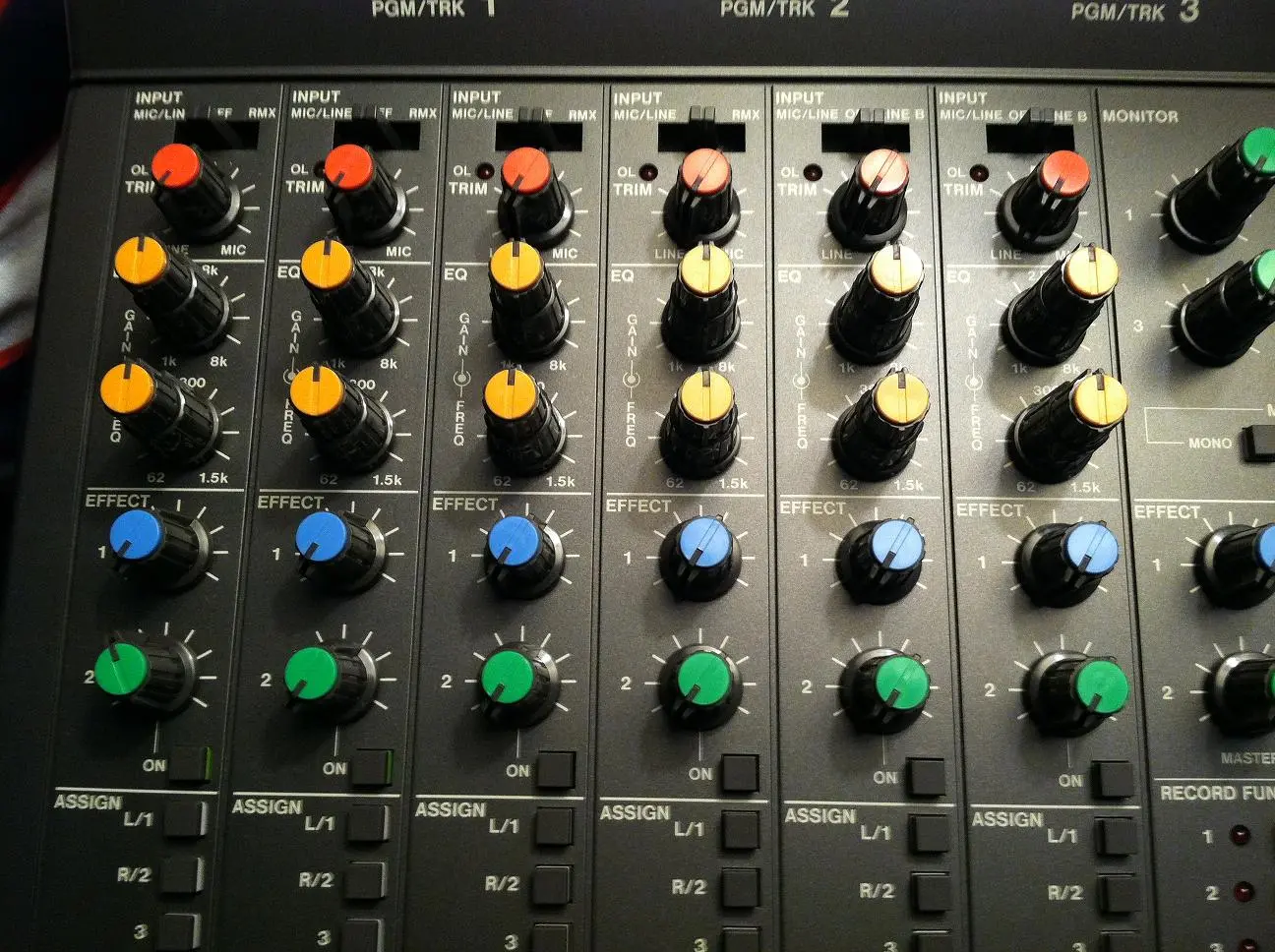

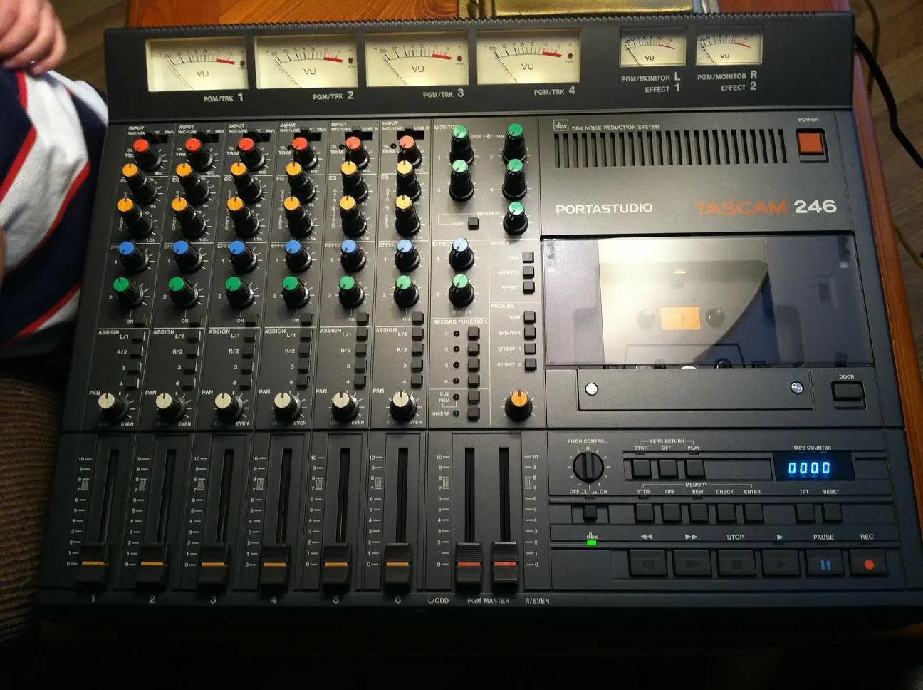

After about 4 years of waiting, I'm finally the proud owner of a shiny Tascam 246 in amazing condition. This thing looks basically like new, and the heads look brand new. I haven't had a look inside at the belts yet, but I've already ordered replacements for the capstan belt, control belt, and idler tires. So here's hoping to many years of 246 bliss! :)

Umm ... first chink in the armor: I was getting ready to put it through its paces today and was stopped short. The head assembly seems to be stuck in the play/record position, so I can't even insert a tape!
I haven't opened it up yet. Before I decide whether or not I want to try and repair it, I'll fully test out the mixer section.
But I was just wondering if anyone had any experience with this symptom on a deck before.
Thanks!
Yes,...
It is the control belt that is responsible for deploying & retracting the head. It's a little square shaped belt, in your case that might be loose, slipping, or given up the ghost. It's an easy fix if you remove the bottom panel. Refit the old one, determine why it's slipping or replace it altogether.

Awesome! Thanks for the tip! I have a new control belt (and capstan belt) already in the waiting, so I'll take a look tonight and see if I can spot the issue. Fingers crossed! :)
Update: Well I removed the back cover last night. The control belt was completely broken and just wrapped around the small post, and the capstan belt was so loose and stretched out that it was just flopping around. And this guy told me that he'd check all the transport controls!
The good news: All the mixer functions work perfectly, and he refunded me $50 to cover the cost of new belts and idler tires. Now I just have to install the belts and check the record/playback/erase functions. Hopefully they'll all be good and I can call it a day. I really don't want to have to ship this thing back!

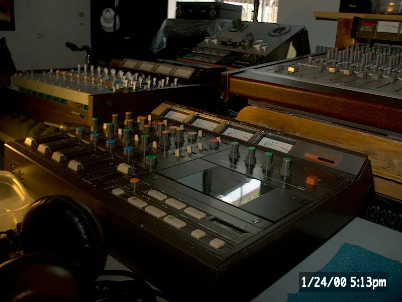

As you guys may know, I've been selling a lot of stuff to make ends meet. As my gear storage goes deep, it's been quite a nice alternative for me. Not only do I need the extra money, but it's been a good way to simplify my life, as well as moving some unused equipment onto someone who's really going to use it. I've gone thru several of the recorders so far, and the buyers have been uniformly happy.

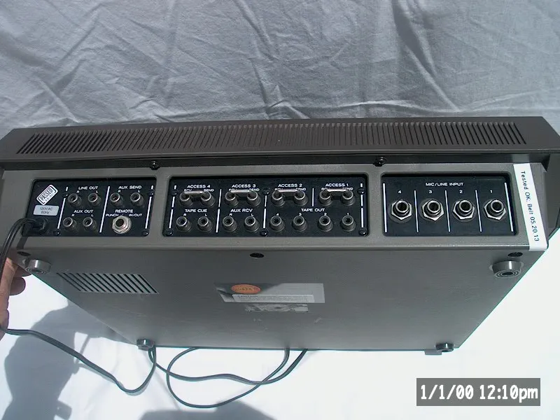

Anyway, I've sold (2) M30 mixers so far, (as well as a whole variety of stuff), and I have 1 more M30 to sell, while I'll keep the last one for myself. One M30 mixer I knew was in a large flight case in a stack of stuff in the garage. A very large and heavy case it was. When I dug it out of the stack, turned it over and opened it up,... YEAH! Sandwiched into the case upon foam was a very clean and minty 244! Don't ask me how I must have forgotten it was in there!
The quick version of the story (?) is that I tested the capstan & hub motors without a tape, by depressing the cassette-in microswitch. All seemed well. By the time I located a tape to test the unit, the Play motion had ceased and the capstan had stopped. Fortunately, I had an 11.7" flat belt in a bin in the garage, so I replaced it. The original belt was extremely stretched out and flaccid. It apparently had just enough rotations left in it for that quick spin test, before it simply slipped down and off... faster than my pants on a Friday night! OMG, I just had to say that! How often do you get to use that line?
After a quick replacement of the main belt, the hidden 244 from the mystery case tested out completely. I was very pleased! Not only is it a great unit to do recordings on as the mood strikes, but if I feel in a pinch I know I can turn it over for at least $150, if it really comes down to it. The buttons are slightly yellowed, but it's in really good condition and tested great! I like happy, fortunate suprises like that.
