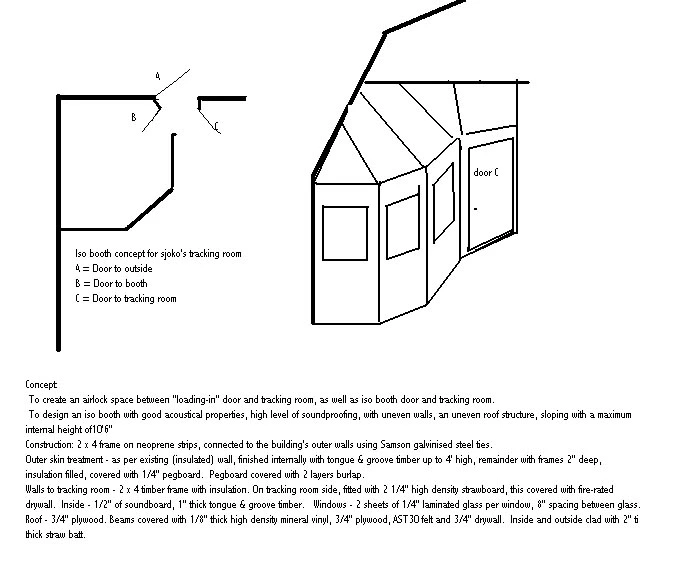

Enclosed is a file with the proposed iso booth for my studio.
Sorry 'bout the quality of the drawing - did it in windows! Got to download something decent again, I'll have time when I finish building ..... eh, will I?
I would really welcome all comments.

Looks cool sjoko...have you got air con in there?...gasp! ;)
cheers
john
I'm running one 4" flex duct in there of the main line in the tracking room, with adjustable airflow.
The only thing I'm still wondering about is if I will need some sort of return out of the room, to avoid a pressure build-up. I think I might be able to do without, as the roof is quite high, so the booth has a decent cubic capacity. What do you think?
