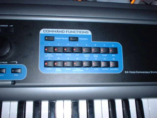

ok so i just bought a new pk6, and while learning how to save presets, i set my wallet on the preset select button. and when ever i would hit a preset to select it, it would just continue to turn on the lights of the presets with out turning the previous one off....
make sense?
in the attached pic, you can see that all the lights are on for the preset.
i need to get rid of this, cause it wont let me save presets to the ones selected. is there any sort of factory reset on this key board. is there a battery like a computer would have for the presets i can take out?
Switch the unit off and switch it back on while pressing the 2 cursors. You will open up the diagnostics menu. Choose reinitialize and do nopt touch the reset NV RAM or chipsets.
thanks alot man, now i can actually get to all my presets that i need for my band.
