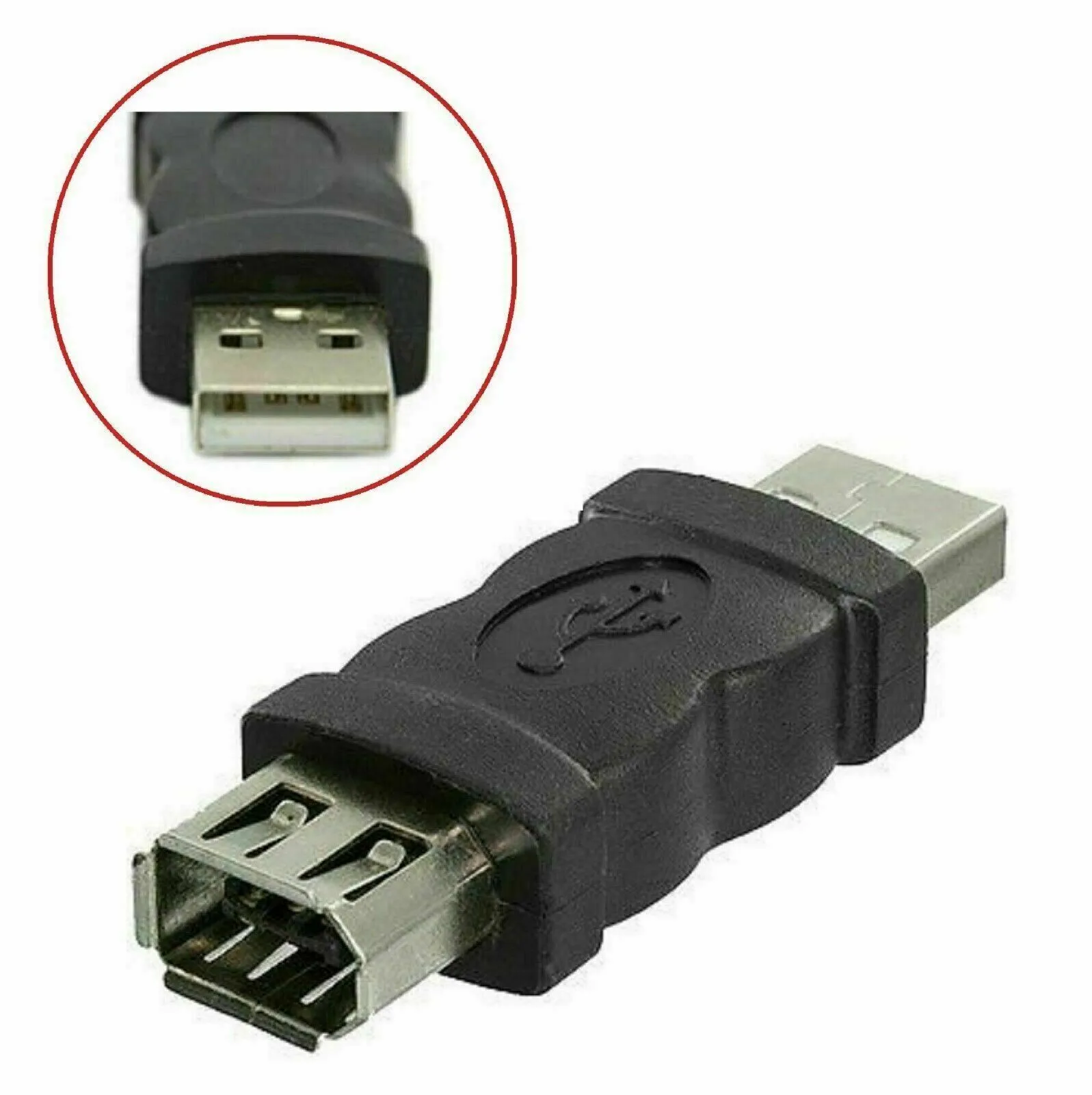

Hi! As I said in the thread tittle, I have a M-Audio Profire 610, but it has only the possibility to connect via firewire 400. I have just usb 3 and usb c to do the thing. Is there a cable or a possible alternative to make it work? Is it possible to use an existing modern cable which convert the data between both equipment? Is the adapter in the photo I attached a functional way? I really hope someone can help me. Greetings.

AFAIK there is no way to adapt USB 3.0 to Firewire, they are totally different protocols. There are Tbolt to FW adaptors but I think they are a bit hit and miss on legacy gear?
The only ray of hope I can offer is if you can find a laptop such as my Lenovo T510 which has a 4 pin FW port. I see the Profire has a separate 12V power input. But even then you might not be out of the woods! I remember the "Great Firewire Chipset FU" of some years ago. Basically if your computer did not have a Texas Instruments 1394 chipset, you were *****d!
I guess you don't want to spend out on a new AI but I think that is inevitable. There are many really good USB interfaces around now at the $200 point. One such is the excellent MOTU M2 . M4 or M6. Naturally more $$$s gets you more facilities. The absolute dog's danglers for quality and especially longevity is RME.

Hi guys, thanks a lot for the answers. Nop, my laptop has no firewire input. Has a Mini-Displayport (Like the thunderbolt 2). I do not know if with a firewire 400 to thunderbolt 2 cable it might do the job. But I found this (Link below) on Alieexpress how much reliable is this?
