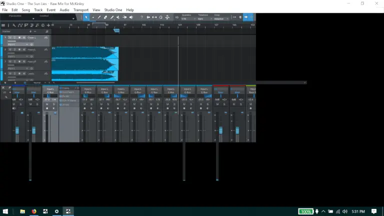

Great. Clicked the update button on the main Studio One page (figured, why not), installed it, restarted computer, opened program.... and the title page is waaaay off to the right side of the screen. Unscrollable as well. The left side of the screen was all black. The interface completely bugged out.
I was still able to open a song file, though I could not scroll and the bottom of the page cut off before the channel faders, so I can not even adjust anything on the channels. If I tried to click any options like "file" or "view", the text that appeared was glitching all over the screen.
Called PreSonus for help - nothing. Opened a post in their forums - nothing. I literally cannot access any of my files because of something they did (not me. It's not like I spilled water on something where it's obviously my fault) and they will not help me. I'm done with this company. Checking out ProTools.
- trying to figure out how to remove an update. I may have to completely uninstall S1 and then reinstall a "previous version" which I found the link for. I think I need to export the songs a particular way within the program itself (which involves me being able to navigate in it!!!) to be able to open the song files/projects within another program. I don't want to lose my work, obviously, so I'm being careful about deleting anything just yet.
Here's what a song page looks like right now:

[MENTION=191190]jkuehlin[/MENTION], any issues with the user interface/graphics display lately? Did you install the latest 4.0.1 update?
-SOLVED-
Christ, what a pain in the arse. I knew there had to be some kind of scaling/graphics issue, so I looked everywhere for how to edit that program's display settings. The option I needed was only found, just a minute ago, by:
right clicking Studio One icon on the taskbar, then, properties->compatibility->change high DPI settings->uncheck "override high DPI settings"-> apply.
Opened it up and bam back to normal!

Wish I had seen your post earlier as I knew the source of your issue. Back in May when S4 was released, the selection for high dpi scaling was removed but they added it back in 4.1. For everyone who enjoys the large real estate with 1080p/4K monitors, the resolution needed to be tweaked due to disabling high dpi etc. Regardless, I went through the same issue but solved it the same day as I had seen the same thing occur with other software that uses high dpi. I saw the post below on the Presonus forums for S4:
Completed 4.1: Please bring back the option to disable the High DPI scaling - Questions & Answers | PreSonus
“Completed 4.1: Please bring back the option to disable the High DPI scaling - Questions & Answers | PreSonus
Try 2nd link inside the quotes if 1st doesn’t work.
