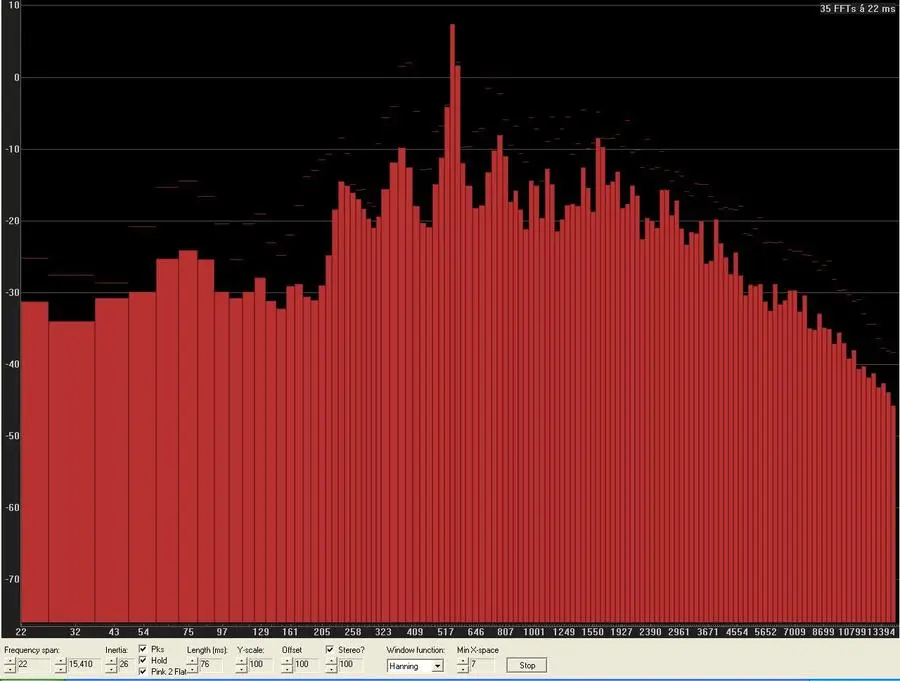

Background: I have a bedroom over the garage that I will turn into a practice studio. The house is 5 years old and well insulated/air tight. Inside the untreated room the sound pressure measured 95.5dB. Downstairs (and in the opposite corner of the house) in the family room, it is 58dB. My closest neighbors are 12' away and the SPL at the property line was measured at 55.4dB. Most of the djembe's sound is mid-frequency, so I don't have a huge amount of bass to attenuate (RTA spectrum attached).

You're talking about an un-amplified drum, right?
I wouldn't do anything.
The background noise floor in my room is about -55dBFS on a good day.
Check your local sound ordinance, but in most places you can go to 80dB at the street.
Yes, the drum is unamplified.
Again the primary concern is the noise in the family room downstairs and on the opposite side of the house from the studio. Currently the sound in the family room is too high at 58 dB when I drum in the untreated studio.
The SPLs at the property line are well within legal limits, although not necessarily below annoyance levels, particularly when the 2 year old's room is directly opposite the studio 12 feet away. I haven't had any complaints from the neighbors, and don't want to. My daughter has remarked that the drum can be heard outside, but it's just audible. About the only thing I'm considering to treat the sound outdoors is the window plugs, which should be good for another 6 dB and get things below 50 dB outside.
It's good to know that if I get the levels down to 50 dB inside and out that it should be below the annoyance level.
Thanks!
