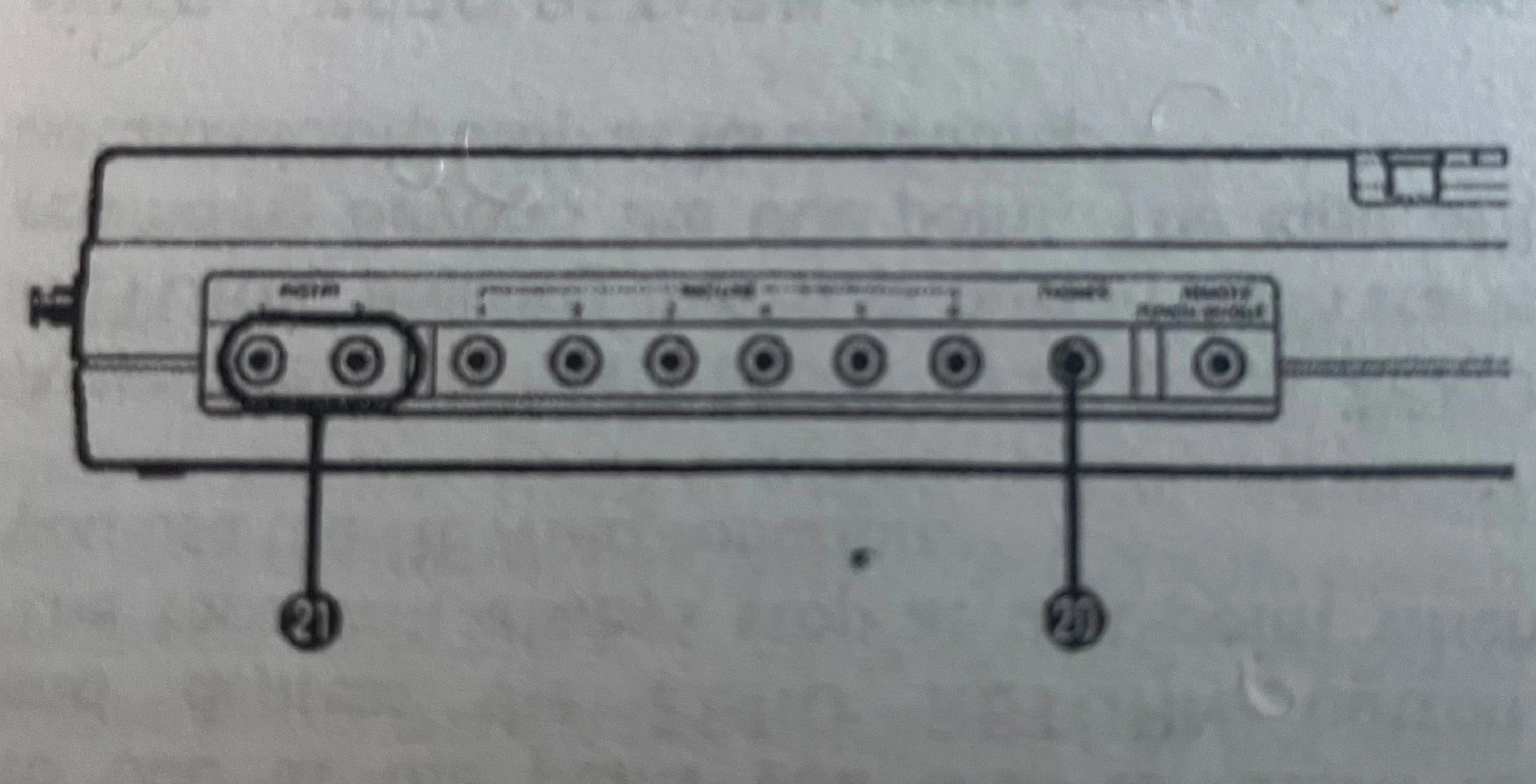

Hi all,
I just bought a refurbished Tascam Porta Two and I'm ready to begin my home recording journey. Any tips, tricks, or advice will be greatly appreciated. The first question I have is, what are the two insertion channels used for? The owner's manual describes the 1/4" jack needed to use them but doesn't explain how to use them. The second question is, is there a way to feed reverb to the headphones without having it be recorded while recording vocals? Sorry if these are "dumb" questions, but when I say I'm starting at ground zero, I mean it.

I've never really used inserts, but they allow you to temporarily plug an effect into the input signal. That will be recorded to tape during tracking.
The effects bus (the send/return connectors on the side of the machine) is applied to all channels which have the effects knob turned up. That happens during playback so it's not recorded to the individual track, and it sounds like what you want for the reverb thing.

The inserts can also be used during mixdown, FWIW.
So, for example, if you had some vocals on track 1 and guitar on track 2, and you wanted to run the vocals through an outboard compressor and the guitar through an outboard effect (or guitar pedal) during mixdown, you can do that.

Nobody has said this yet, but to use an insert socket, you need an insert cable. This is just a cable with a stereo jack at one end, and then the cable splits into two mono cables, each with a mono jack on the end. The deal is, the signal from your mixer/recorder leaves on one of the stereo connections, goes into your external processor from the associated mono jack. Then leaves the external processor on the other mono jack, and re-enters the mixer/recorder on the other connection of the stereo jack.
Insert sockets can also be used just for a handy signal output.
