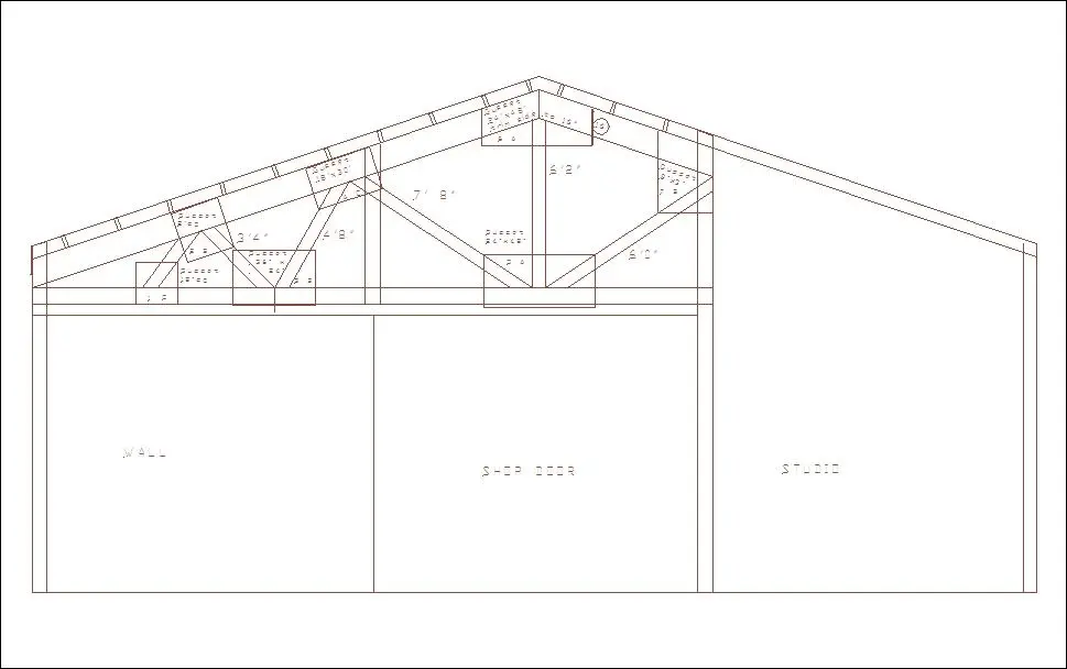

Fitz, here's a lo-res dwg of the trusses I built in-place in my barn, I didn't need the whole span so trussed 2/3 of it. You can see where the pole was, in the lefthand third of the pic. I just used 1/2" ply for gussets, the 2x12's were already there - I added the horizontal chords and the diagonals. Just make sure you have a peak where the original support was, and continue the zig-zag til you run out of room. I used 5/8 bolts and large washers drilled through the poles to mount - my poles were square cut creosoted 6x6, and I used 2x8 bottom chord and 2x6 diagonals. I drowned each gusset in Elmers construction glue, and played John Dillinger with the nailer filled with ring shank #6's while each gusset pair (one each side of the truss) was clamped. Left the clamps til the glue was dry.
I was planning on doing these on each side of each pole, but winter beat me to beta test - we had 90 mph winds that year and the barn was still there in spring, so I figured, "IIABDFI", which of course stands for, If It Ain't Broke...
BTW, once the first trus was in place for each set of poles, I cut that pole and dropped it out. Then I pulled the stumps out, already had the siding off, used a medium sized Kubota and cleaned out all the loose crap so I could have the slab poured.
