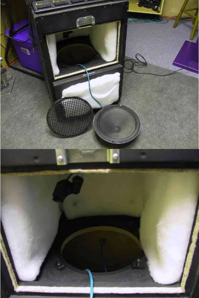

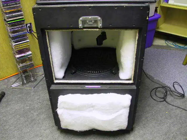

Here's a Speaker box I made about five (5) years ago.
I also used it while playing local clubs. I'd prop the door open to control stage volume.
-kp-

Here's another photo pf one you can actually "buy" from Demeter. They want a whopping 350 bucks for it and that doesn't include a speaker or mic! It's insane! You can make your own out of 1/2"-plywood (or particle board) for for less than 50 dollars. I made mine so that the speaker was on its own plywood panel and made a little slot so I could slide it in and out if I needed to. You need to have a small hole in the box somewhere to accomodate cables for the mic and speaker. I also laid a 2" thick piece of foam down on the side where the mic sits so that the mic wouldn't pick up any vibrations from the wood. My box is about 16" wide by 24" long and has a single 12" speaker. You actually need to build a second box around the first one and get some of those sticky foam strips from radio shack (comes on a roll) and apply it to all the surface edges where the two boxs are screwed together. I highly recommend screws instead of nails. Nothin to it! :)

hey Windowman, i think you're understating the case... :)
it's going to run a lot more than $50 to do it right but probably less than $250 by the time you've bought the fiber board, jacks, gooseneck, paint, handles, speaker cover, wheels (optional but recommended), door latch, door hinges, mic, and speaker. i recommend a WEBER or Celestion speaker.
i wouldn't use anything less than 3/4" medium density fiber board for the box with 3/4" or 5/8" plywood for the speaker baffle.
definitely use a lot of screws and glue (a must).
it's not a piece-of-cake to make but also not that difficult if you have a table saw and the proper drill bits.
when i played clubs with it, i used a Sidewinder. i blew the first Sidewinder during a gig one night. now i have a Celestion Vintage G12.
-kp-

Hey, you're hardcore aren't you? :)
I kept things very simple; certainly no cover because I never planned on it leaving the house. No handles either for similar reasons. I don't even use a mic stand, let alone a gooseneck. I just lay the mic down on that 2" piece of foam in front of the speaker. I've got a removeable top on mine so I can slide the speaker baffle in and out real easy in case I want to try different kinds. I used some thumb latches to keep it on with. No paint and no wheels. This thing just sits in a corner and looks ugly but it works. Deffinately the poor man's approach. ;)
Did you build a box within a box? If you didn't then I'd say you're on the right path with the thicker wood. Since I went the two box route though, I've got a full 1" thick sides with both box sides combined. It seemed plenty at the time. It certainly wouldn't hurt to make it as thick as possible though just to help keep the noise inside even more. I don't have any kind of covering on mine either; just bare wood. It's good enough for what I needed but I would think that a good thick covering (even old carpet maybe) like Demeter has on theirs would make it even quieter. Depends on your needs.
I like your more professional approach but I need to eat too. :)
