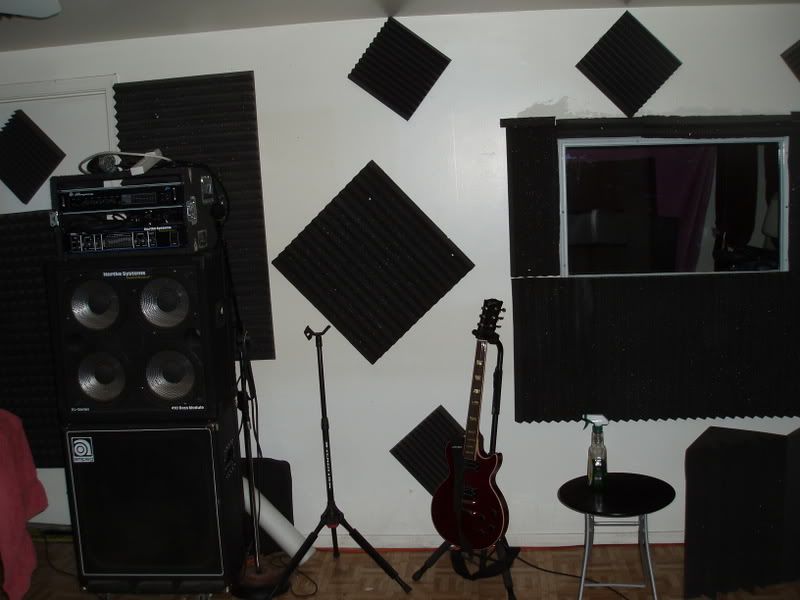

this is the wall to the right of the mixing position (facing drum room door/bass stack)

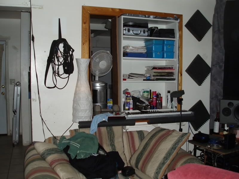

and to my left of the mixing position (note above the couch I have an opening to the kitchen, half covered with a bookcase and fans directed towards mixing position)

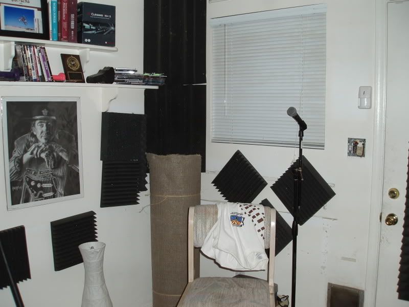

this is behind me to the left of mixing position (laundry room is missing door, the brown board is my makeshift door)
and the opposite corner (just barely showing the door out)

So my questions are . . .
should I fill in behind the rigid fiberglass corners (w/laundry,pillows,etc)?
should I rearrange anything?
do i need to buy more rigid fiberglass and/or place in more strategic areas?
thanks so much for any and all input!

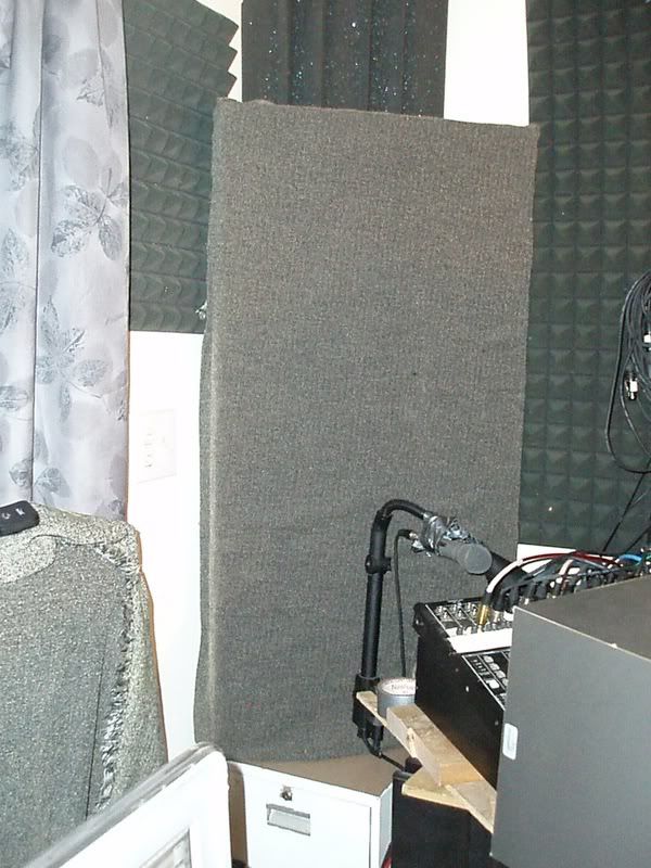

The corner behind my right monitor illustrates my dilemma.
The bottom of the corner is a near full (heavy and dense = little absorption?)metal file cabinet. My logic is that the cabinet will a)help eliminate the characteristic of the bottom corner as being a 'true corner' because now it is 'less resembling of a corner' 2) makes the room less symmetric.
I don't think this will help to absorb the bass fq but I OBVIOUSLY have a very limited knowledge of this subject and just know that bass build up is primarily in corners. So the inverse must be true? ie. if that corner is less of a corner now?
Above the file cabinet I have a 4" OC 703. THere is nothing absorptive behind this void (like pillows) making that part of the corner less dense.
Now, above that there was still the top corner exposed so I put an auralex bass corner trap there. The properties of that are clear, filled in void,absorptive, matter is not dense.
Perhaps that last sentence answers my own question. This is what I need to shoot for . . . independent of what the assigned definition of 'professional bass trap' might be because I am out of material, but can still move things around.
This leads to my last question do I need all of the corner to be covered, top to bottom?
This is because in my top post , the second pic (behind my other monitor) I do have qty 2 OC 703 4" (void filled) stacked on top of each other but it stops just short of the ceiling by 5 inches. If need be I can cut some 703 from my drum room and fill that in - if it's worth it. Perhaps I should not use the words 'fill it in' as at this point I am under the impression to just 'cover it up' I just ran out of the 703 (wish I could have bought yours!) to do the like, top to bottom, for all corners. But I did make a drum cloud that I can take some from. Think no funds, but can shuffle things around and improvise.
