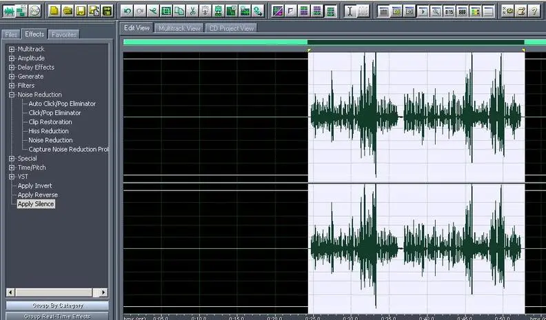

The following attached pic is a part of my vocal which I recorded and its volume is not regular :

You most definitely do NOT want to normalize your vocals - Compression is another story.
In any case, by "looking" at what you have (I hate to do that) your tracks are waaaaaaaaaaayyyyyyyy too hot. Normalizing will take your available headroom to *0* on just ONE track.
You're generally looking for peaks of *maybe* -12dBFS or so on vocals - Tracking and mixing.
After that - There's rarely a "normal looking" vocal - Unless it's squashed to death. There's nothing wrong with dynamics. I'd highly suggest you stop *looking* at what you're doing and start listening.
