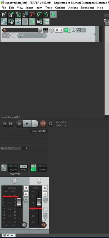

On the mixer.. The track and master faders are both at 0. I see the master level meters constantly peaking into the red, maintaining a +10dB level. The track level meter is at -12dB. Increasing the gain from any point in the chain greatly increases the master meter readings and barely moves the track meters.
I'd like to know why the large difference in meter readings. My memory needs refreshing - please.

I was just wondering why there is such a large difference in meter levels - with the interface input gain at it's lowest setting resulting in constant DAW red peak readings and constant +10dB on the master meter and only -12dB on the track meter.
When I increase the gain on the interface so the green light is constant (no red at all), the track meter level rises above 0dB and the master meter goes solid red into peaking.
I understand not to worry about the DAW levels for now.. I'm just curious why the large discrepancy between master and track meter levels.

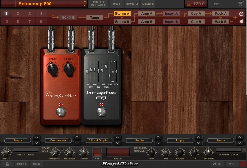

Thanks! ;) It's just the guitar straight into the interface - no master bus plugins, comp or limiters. HOWEVER... in the amp sim chain I have two stomp boxes.. one is a compressor which makes me think
@Farview's response may be the explanation I'm seeking. Makes sense to me.

Do you see your "input" volume pot on the bottom left? Turn that to midnight. Try that.
Ok. That does lower the master level readings, leaving the track level readings unchanged - drops the master meters to around +6dB max - doesn't go much lower than that on the meters, even if I turn the knob all the way down.. only drops to about +4dB. This also greatly reduces the headphone monitor volume, so I have to turn them up to max otherwise I don't hear the full effect of the guitar and sims.
Now, this is when I'm using the amp sim while recording. I haven't recorded a dry guitar, then applied the sim afterward - don't know what to expect there. I really want to record wet so I can really get the feel of it. Or at least monitor it wet while recording dry.
Stop! Back up.
The track meter is showing the input level from the interface as is. Changing plugin settings or fader positions will not impact this ever.
The Master meter is showing what's coming through the plugin chain, modified by the track fader and mater fader. Your plugin is adding gain. It's that simple.
Now, the numbers you're reading on the master meter are not the same as you're seeing on the track fader. You've got your master fader showing both peak and RMS levels, and you've got the RMS levels offset by 18db so that actual RMS of -18dbFS read out as 0. This makes it look more like an analog meter where 0 is "nominal average level". But then you're not looking at where the outside meters are hitting, but rather where the inside meters which show peak levels are. But those meters are meant to be read against the inside scale. In your case, your peaks are hitting around -6dbFS on it's way out to your speakers.

That pretty much nails it :D Thank you!
Good. Did you also understand my point about how you were misreading those meters?
Yes. Since I'm not too deep into the (new to me) digital recording processes yet, I'm not sure when to refer to which numbers. This has helped, along with explaining the large visual difference in meter readings I'm seeing.
