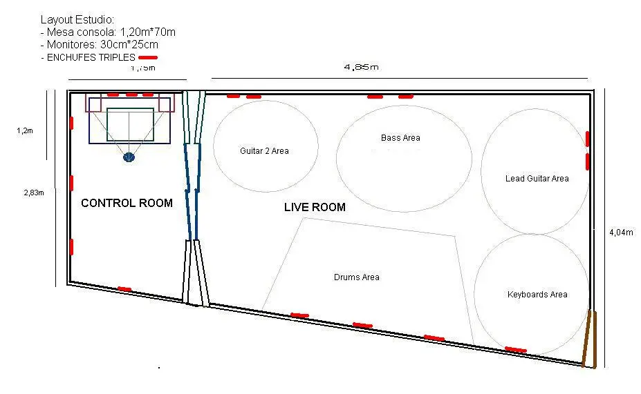

So... here is the last version....
Thank you for everything:
I saw johnlsayers.com website and got some new Ideas about that.
Also I took some of our guru wisdom and I changed the window for a "window door" and changed the Bass area with the lead guitar's....
I talked with my arquitect and told her it must be as high as it can be and also gave her directions to floor building...
My studio will be in the second floor of the house over the dining room so it must isolate the floor very well. I saw some people put long sticks about 5cm tall, over the nude floor then a layer of floating floor and then the carpet...
Please tell me if this methodology will kill the sound enough....
Please take a look at the whole thing and if you have any comments I'll be pleased to receive them....
Let the music play!!!!!!
jbascur, not seeing a plan anywhere... Steve
Oups.....
Hope This Work Now.....

What is the translation on enchufes triples? Are those power outlets?

There isn't much to comment on, as it looks fine to me, depending what you're making the traps out of. I wouldn't except foam from any source to be the "magical fruit". Other than that, looks good.
