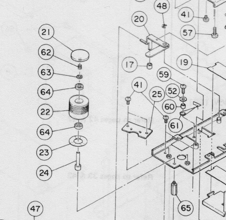

This is the construction:
...so there are two bearings, marked '64' on the diagram - of type MR105ZZ according to the manual.
62 is a spring, so watch for that.
23 is the base-plate, which has about three black markings on it. The sensors are detecting that moving, so make sure it's not damaged.

Does 21 just pop off to disassemble the roller? I have a little tech ability but no pro. Lol

5. Remove the top cap on the tach roller, unscrew it as for the others. Watch out for the spring. I think it will just slide off the shaft now the top plate has been removed.
I'd just take it off and inspect things first before actually attempting to swap the bearings out, just in case there's some kind of obstruction or other obvious problem with it.
Thank you guys so much. I think I fixed it. I pulled the tach roller off and it appears someone re assembled it wrong. Both bearings were stacked on the front side of the spacer. I removed and then in there proper place and now it spins silently with no unnatural resistance! Woot woot! It is missing the spring (62 in the diagram) were can I get a replacement? Anyone have a part number? Hopefully that’s all the issues for now! Thanks again.

The purpose of that spring is to “pre-load” the bearings...to take the natural play out of the bearings and load the balls against the races. This reduces mechanical noise that might otherwise occur and be physically transferred to your tape and possibly effect your recordings.
