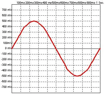

Here is a better version of a 1 Hz sine wave. It is on a graph with voltage on the Y axis, and time on the X axis. When you mix two signals together, you are adding there voltages at each moment in time. If both have a positive voltage, then the voltage at that moment in time will be higher. If one is positive, and the other is negative, the voltage will be lower. If one is 100mV and the other is -100mV, they will cancel out completely. It is simple addition, which is why it is called summing.
I think, Zeke, that one of your problems may be your youth. I do not know what sort of math classes you have taken, but if you have not had at least an introduction to trigonometry, this may be hard to understand. Sine wave functions are a big part of trigonometry, so hopefully you are working hard in your math classes. This stuff is VERY important to understand, and is also very complicated.
BTW, you can not actually hear a 1 Hz sine wave, but it makes for a relatively clear picture.
Alright Skippy, I did the picture, now you make sense of it in words, you seem to be better at that than I am.

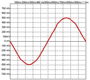

Here is the same signal with the polarity reversed.

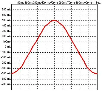

And here it is with a 90 degree phase shift.

ZEKE SAYER said:
I'm sorry but, i STILL do not understand it. For one thing, I don't understand voltige and stuff like that so i'm lost. So what i said about phase in my last post WAS'NT true?
Yes you're getting close.
Another example... Think of voltage as presure, and polarity as direction. An analogy for both could be two people pushing on something. One is pushing up (toward the top side of the wave), the other pushing down with equal force. There is no movement, and the voltage is zero. If they both push the same direction, they go twice as far and the signals add.

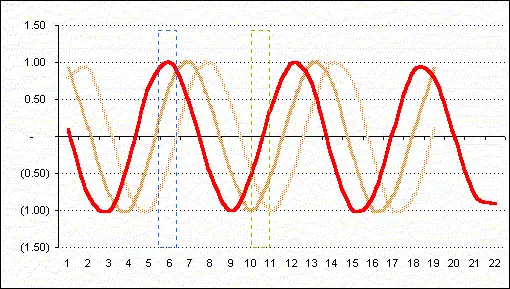

maybe this chart can help.
This is the way I understand it (See the chart below).
The y axis is the amplitude, and the x axis is distance. You see 3 waves, which is the same wave sampled at different times. You also see 2 squares: a blue one for where the mic A goes, and the green one, where the mic B goes.
First sample (thick red line):
Mic A gets a +1 reading, while mic B -0.5 (more or less) reading. If you add them you get +0.5
Second sample (less thick red line):
Mic A gets a little more than zero, while mic B reads almost -1. So that sum will fall around -0.8
Third sample (the 3rd. line):
Mic A reads -0.5 and mic B is near -1, resulting in -1.5.
If mic A was at position 6 and mic B at position 9, both readings will be completely out of phase. If they were at position 6 and 12, they will result in a wave that's 2 times the first one in amplitude.
I hope it makes sense. Cheers, Andrés
