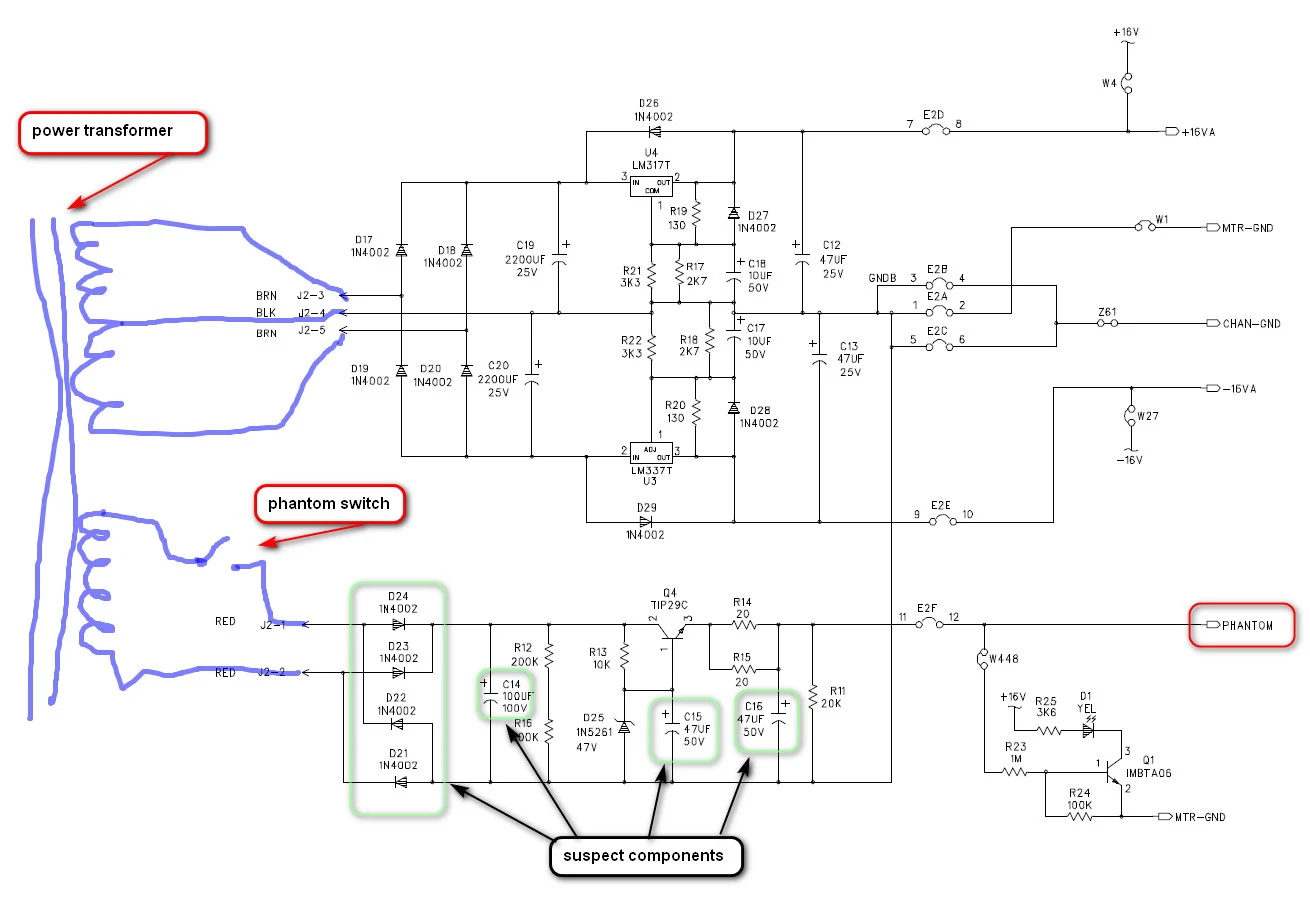

My guess......
Faulty component (shorted?) in the phantom supply circuit. The service manual doesn't show the power transformer, but from what I can assume, the phantom power has its own secondary winding. The AC from the secondary is switched and not the DC supply part of the phantom. A shorted component may load the transformer down so the other half that supplies the rest of the mixer loses voltage and cuts volume to the output. At a guess the phantom indicator light may not be illuminating or maybe dim(?). There is a fuse in the primary, but the faulty component if shorted, doesn't cause enough current on the primary side of the transformer to pop it. There might be an audible hum from the transformer when the phantom switch is on.
I would not run the mixer too long, if at all with the phantom switch on, as it likely could heat up the transformer and eventually toast it $$$$$.
My guess......
+1 Mark, any of those components could be the fault. I would also suspect D20 gone O/C and putting the full rectified voltage on the 48V line
The TIP 29C is not particualrly suited either, only just a high enough voltage rating.
TBH if the fault is anything in that supply (which BTW has NO short or overtemp' protection) is found faulty I would rip it all out save perhaps the bridge (if of generous rating they rarely fail) and replace the whole section with the TL783C high voltage regulator IC. D.Self rates them very highly.
