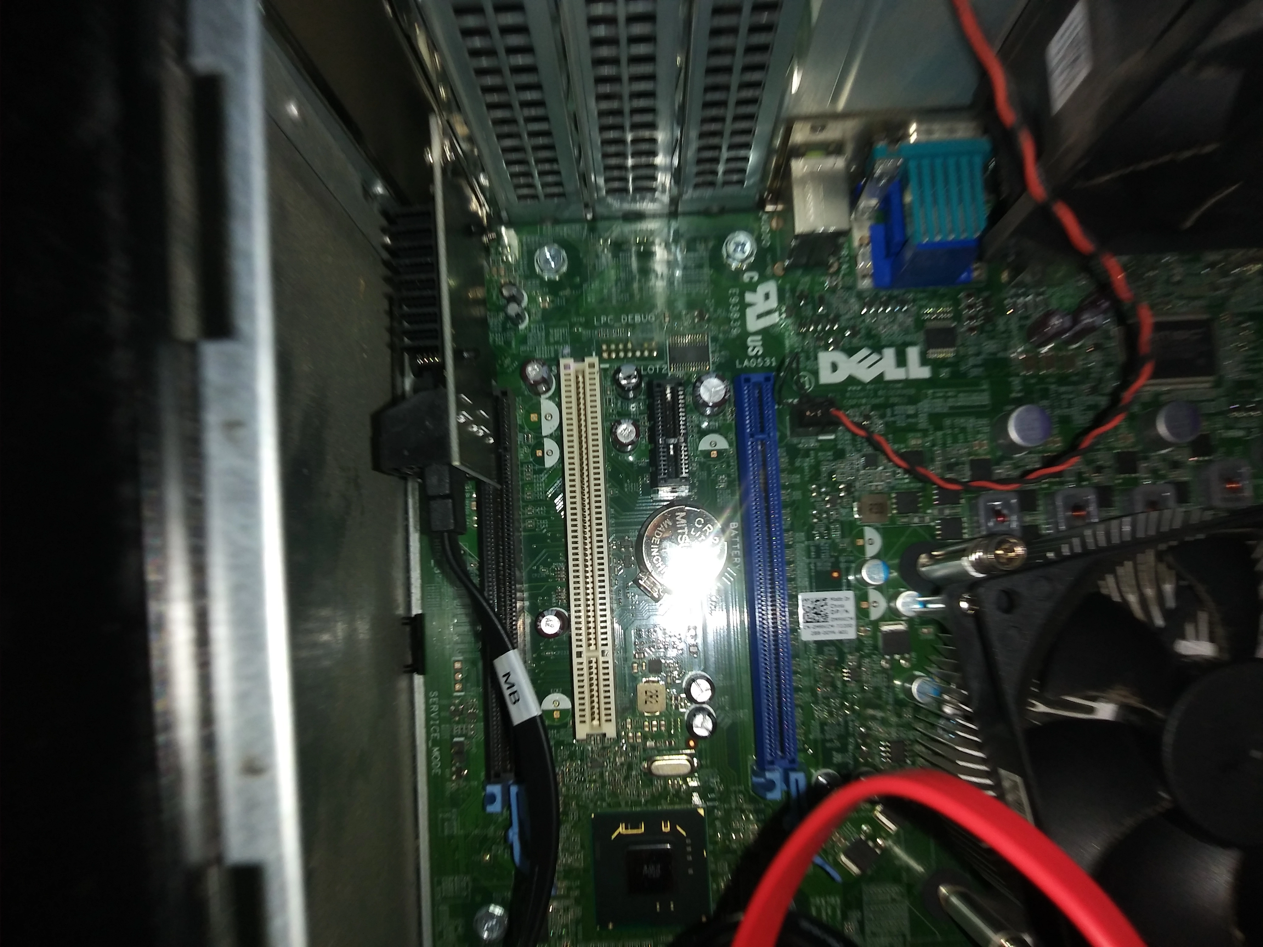

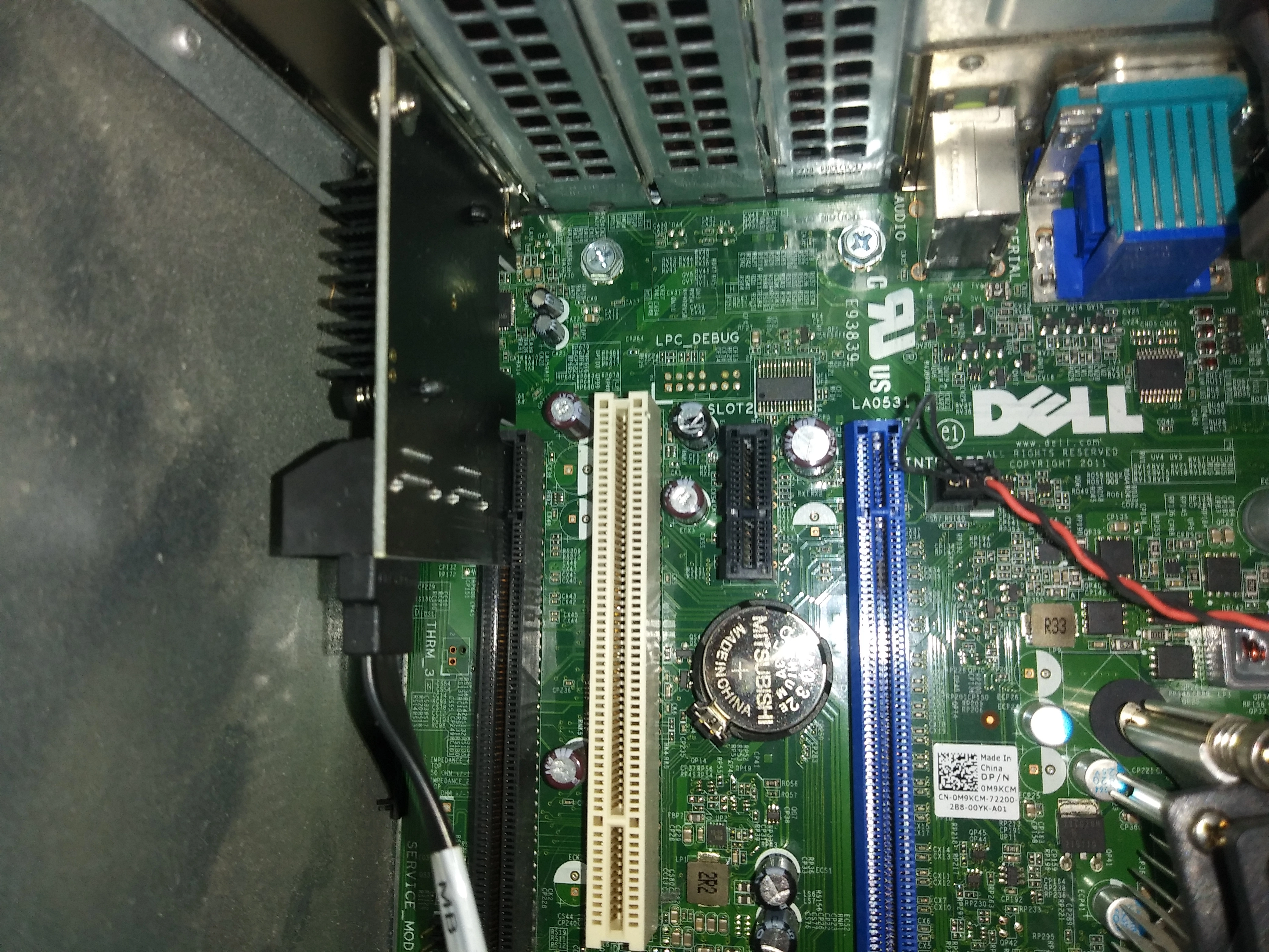

I hooked up that pciexpress version 3.0 4xsata3 adapter and unfortunately it will only fit into the version 2.0 pcie slot. It works in the x16(wired 2.0) pcie slot in my dell optiplex9010 but i won't get the 3.0 version speed as i had planned.. I was wondering if anyone knows why it won't boot up from the pcie version 3.0 slot. The 3.0 slot is offset from the other 2.0 slot and the metal adaper support won't reach the chasis mount.I found out or am pretty sure that the adapter is half or @3 mbps. according to a diagnostic app. So how can i get the adapter to work in the other(3.0-pcie x16)adapter?
One other thing...does the brace or metal bracket on the adapter itself act as a ground and prevent it from working if it isn't attached to the chasis?
Can you post up a pic?
If it is offset, I'm thinking the card is not meant to fit in the slot.
Here are images
Problems solved.
I forgot to remove a spacer-cover on the back chasis.it does fit.
Your black and blue slots are pci express.
Can't say if they're PCIE 2 or 3 but the user manual or specs online should tell you.
It's worth checking some proper documentation. Sometimes they run at X16 with one card installed then fall back to a pair of x4 or whatever if there are two cards.
It's not always straight forward.
The white one is PCI - Old school. Ignore that one.
As for booting from PCI-Express : Some boards support it and some don't.
That's another one for the manual, or maybe check the boot options in bios to see what's available.
Even if it's a Sata3 card operating at its best there's not really any point in figuring out how to make it boot.
As far as I remember your system was already booting from an on-board Sata 3 port anyway.
