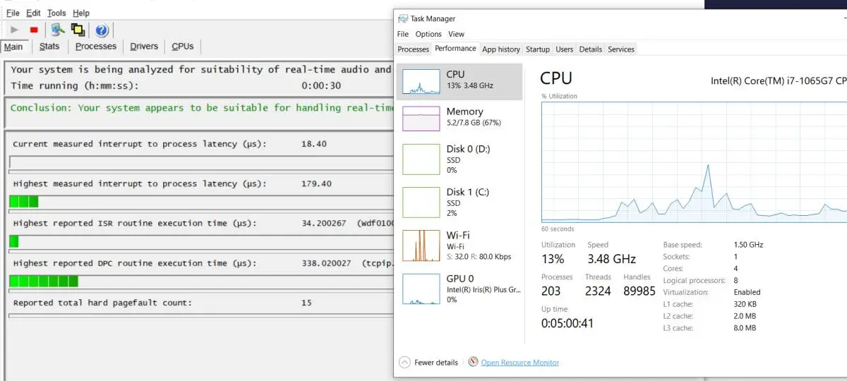

First step will be to download Latency Monitor to see what tasks are interfering with the audio processing. WiFi is often a culprit, as are some antivirus programs. Run it while Studio One is running and see how it is behaving. The system should be capable of running audio. You can also look at processes in Task Manager, including how TurboMode is running. I have a I7-1065G7 and this is my system running Firefox, Edge, LatencyMon and TaskManager all at the same time. You can see the CPU has kicked up to about 3.5GHz. Still overall latency is good enough for audio.
The 1165G7 can be run at 1.2GHz to save on power, and ramps up to turbo mode to a max of 4.7GHz as demand rises. Make sure that you have power settings adjusted not to throttle back, especially if you are on mains power, not battery.

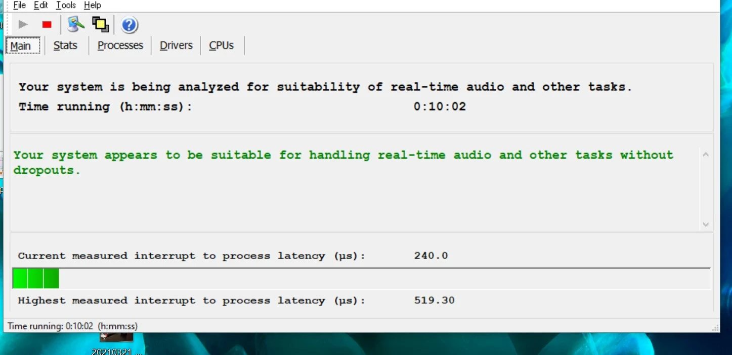

I bought a Lenovo S340 w/I7 and 8GB. I just turned on LatencyMon, and let it run for 42 minutes while I was browsing the web on WiFi, two different forums on different tabs in Firefox. I even forgot it was running.
When I shut down FireFox, LatencyMon was still running and all green. You might still be able to find one at Office Depot. My ex bought two in January, on sale for $500 each.
The battery usage slider supposedly was throttling? Ok, I did that.
It installs the DAW and does record sound. I don't know.
It is the sound card drivers. I uninstalled everything one at a time. Also, I turned off the wi-fi with the button, not disable it from the manager.
