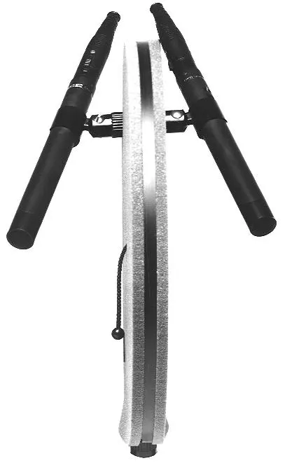

Something else you can do with a pair of omni's fro a little more seperation while trying to avoid phase issues is to use them with a Jeklin dics. That's basicly a type of mount where there is a disc baffle between the twl omni mics. I've made one out of a couple of old mouse pads before. See the attachment.
