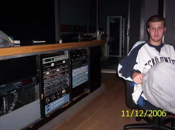

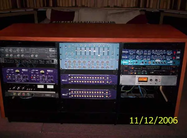

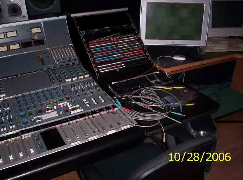

That depends on what kind of processor I would be using. Usually I would send the wet signal of reverb to it's own channel so that I have more control over it. Maybe pan it a certain way etc. If I were to use compression, I would take insert send to processor to insert return. All this through the patch bay of course. For side chaining I would be basically going through the Aux send to processor & aux return. In which, if I wanted reverb on my Drums, I would turn up the aux's on that particular channel by just turning up the knob, or on any track I so choose.
I attached a couple pictures of Studio G & Studio D just for viewing. Everything on the patch bay is pretty much laid out for me.
