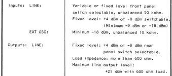

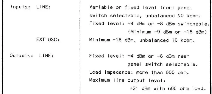

In the manual it says that it's +4dbm or -8dbm switchable.
