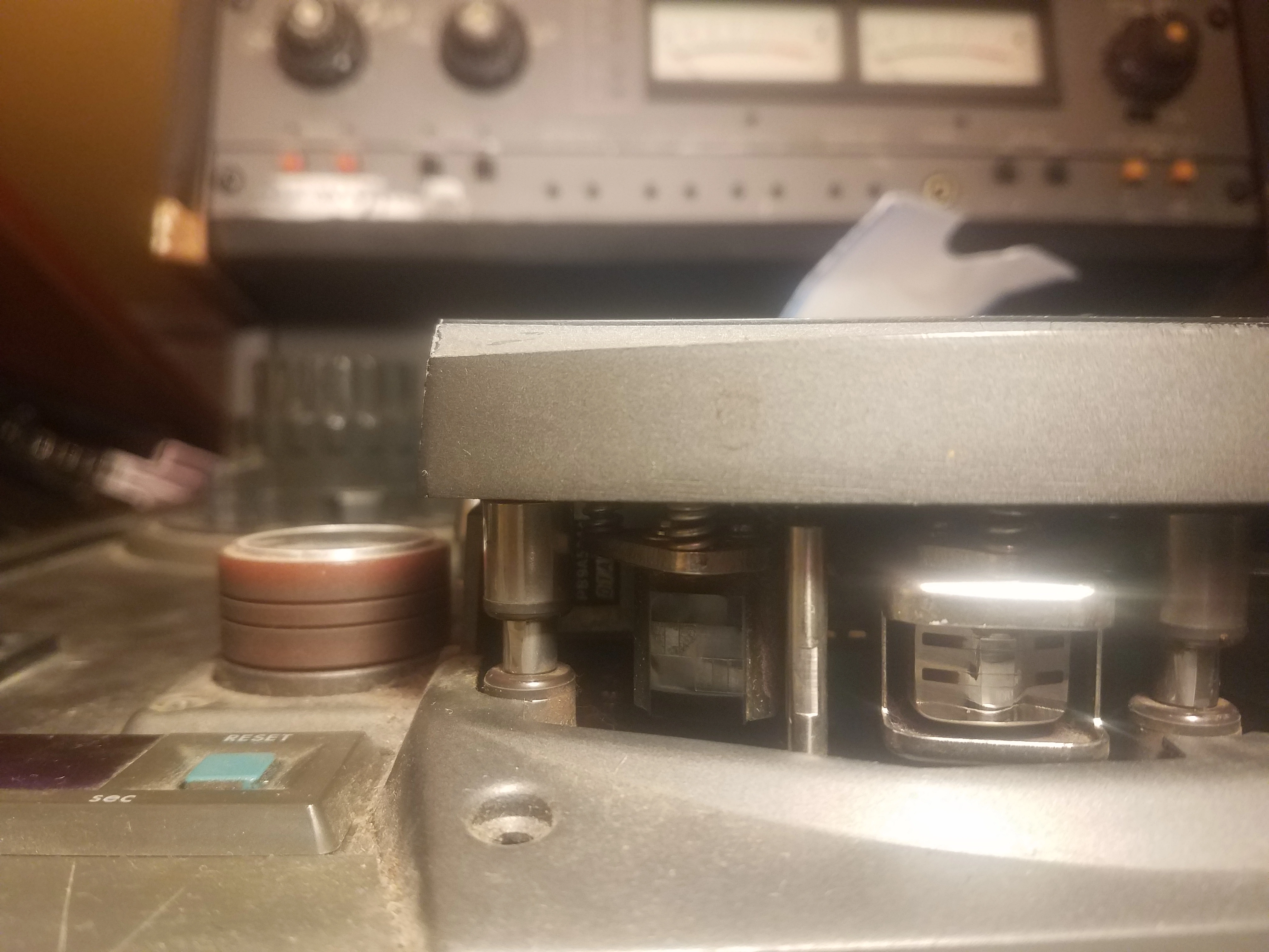

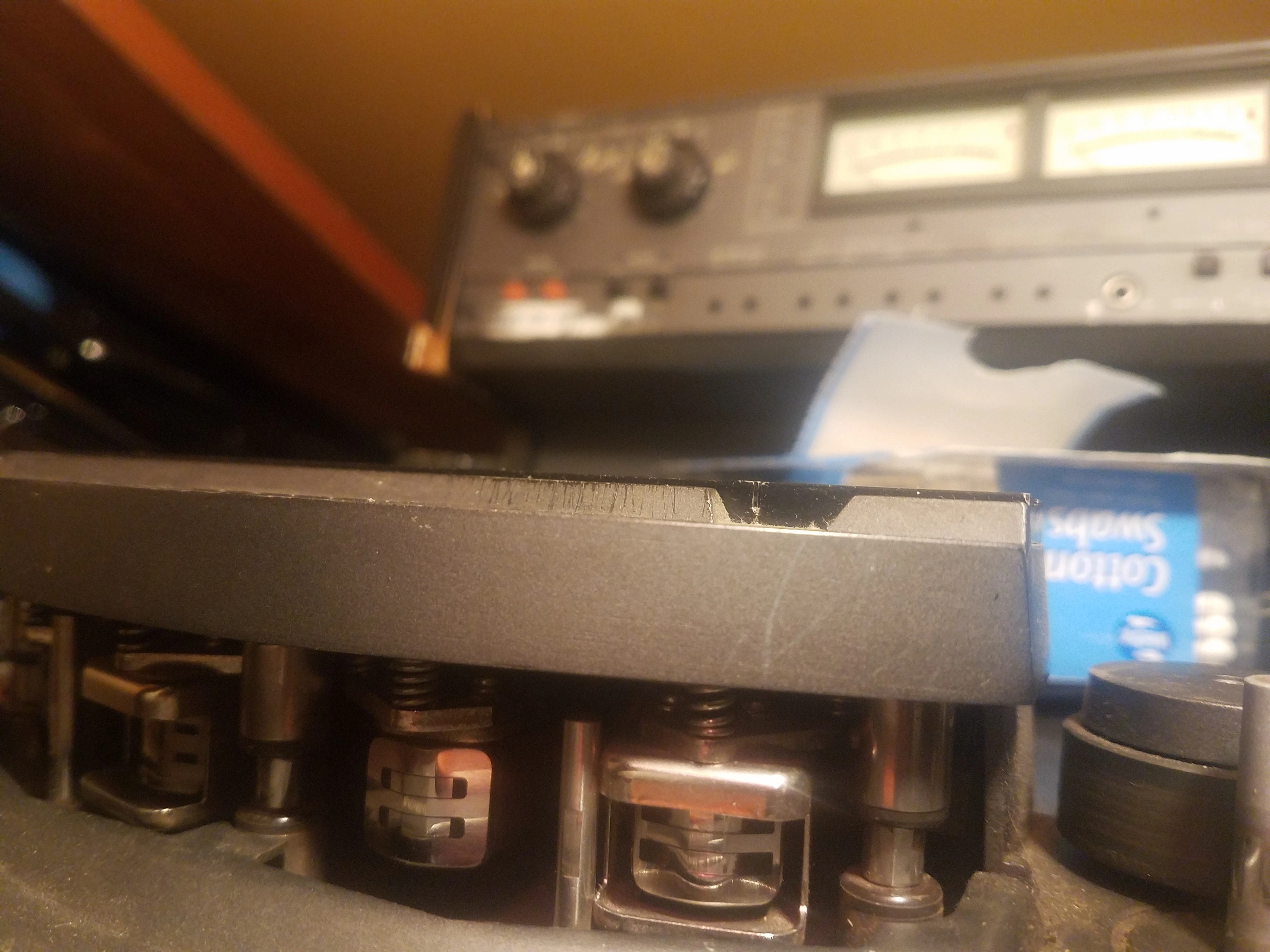

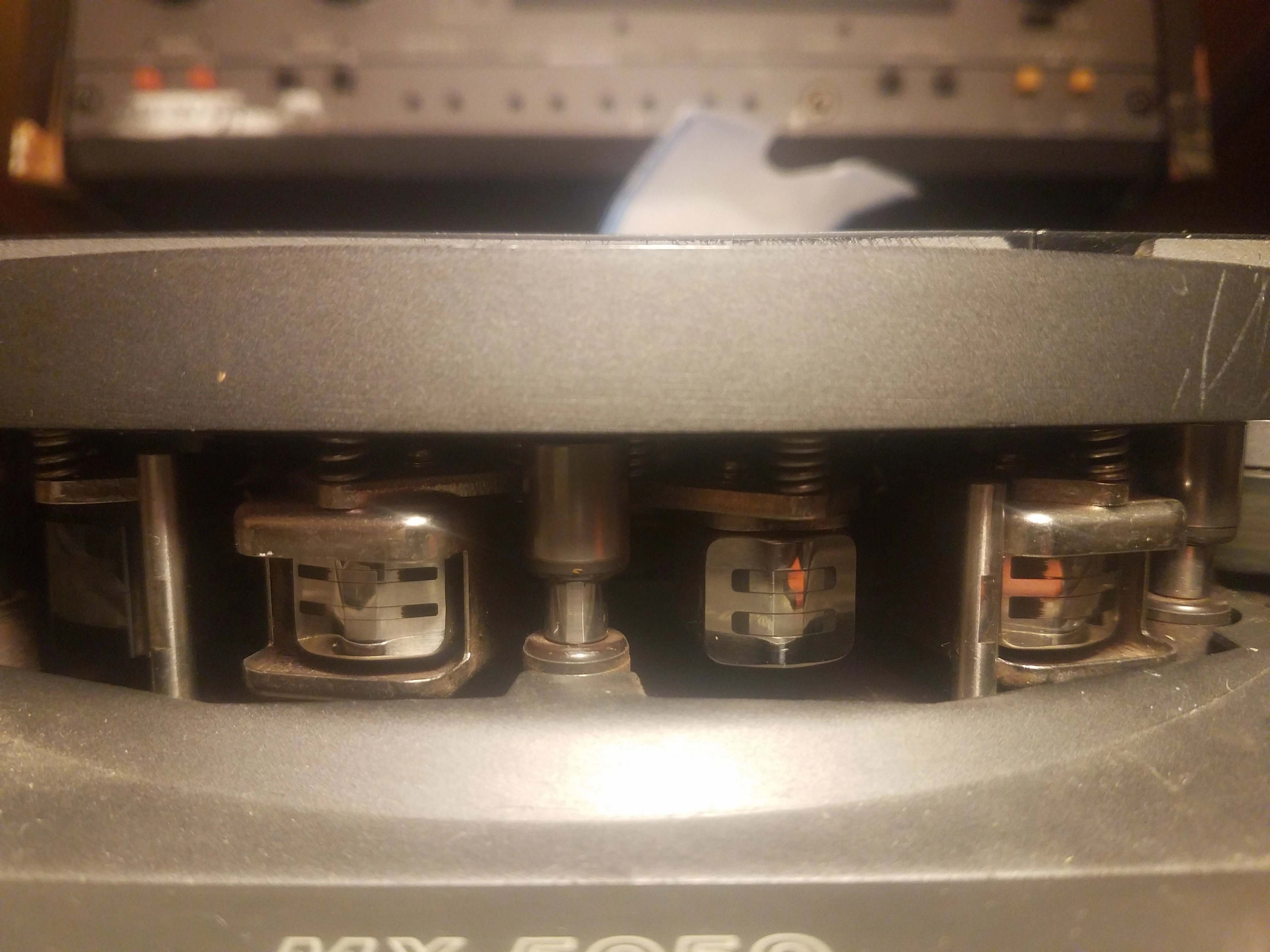

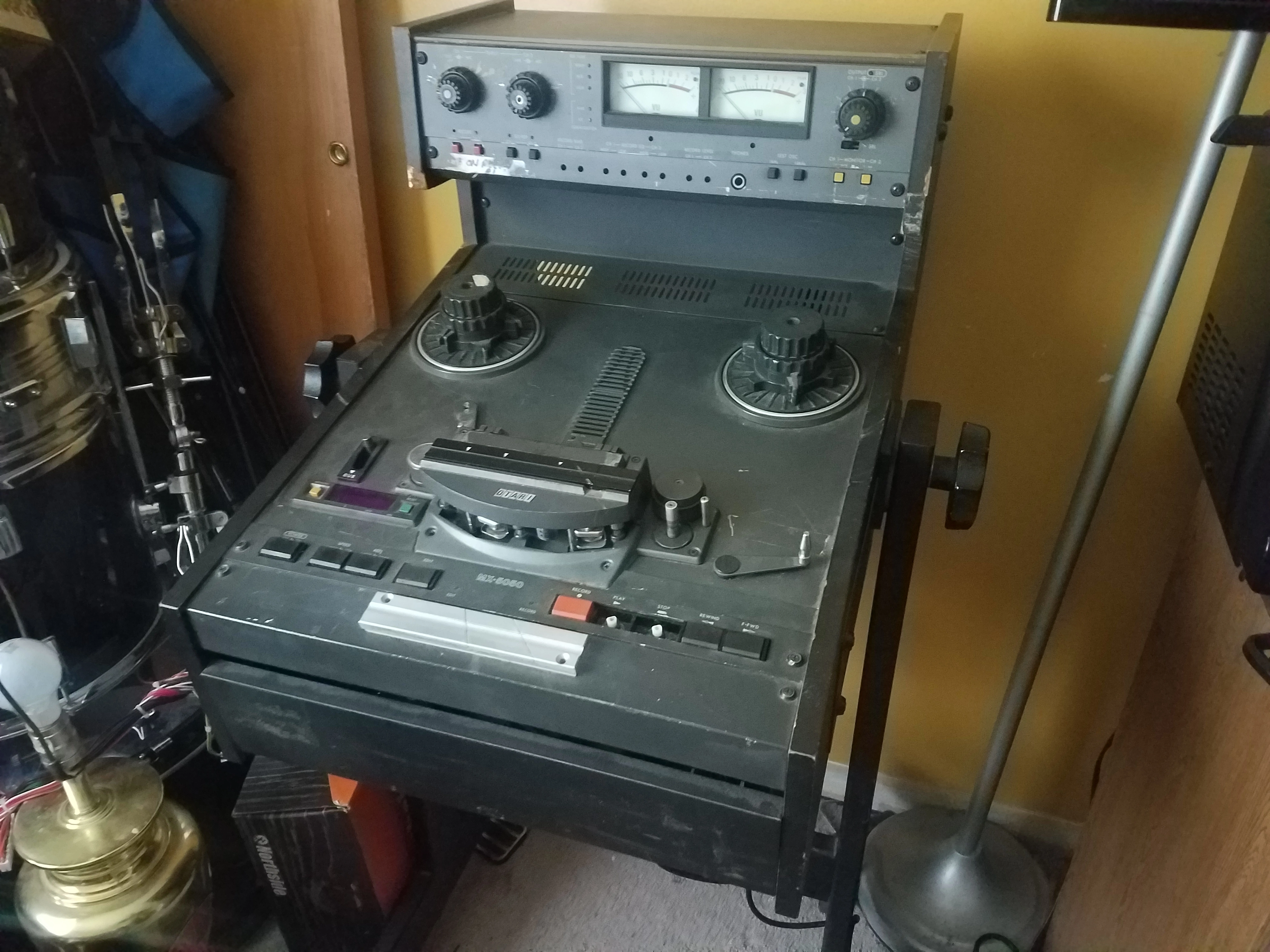

I just got an otari mx 5050 MkIII-2 that spent most of its life in a radio broadcast studio and the rest dormant in the house of an employee. All the guides and parts move very fluidly and the machine seems to still be good for the most part mechanically besides these few things.
1. There is a completely black head marked ER above it (I presume that means it's the erase head) located all the way to the left. I'm thinking it's probably not stock but I don't really know much about this stuff yet. Anyways, the head has a dull mark on it that doesn't seem to be coming off. I'm thinking it may be really old tape residue but I don't know for sure.
So is there a more thorough way to clean than q-tips and alcohol or is this normal (or some random bad sign)?
2. The guides are super worn and I need to get at the stationary ones in/ by the heads but i'm not sure if they unscrew or if they are press fit. They look like 3 pieces. Like two larger diameter sandwiching a smaller diameter guide in the middle. Do they screw out, heat them and pull, just pull without heat, or what?
The Picture makes the black head look a bit worse than it is but the spot is on the upper left section contact pieces (If you know what I mean).

OK, the left-hand head is the eraser. The actual erase elements are normally black, or dark metallic, with the rest of the head surface being plastic. Usually it's white, but it looks like some of the Otari ones are black plastic.
From these pictures I can't see anything catastrophically amiss, though there is clearly a bit of wear on the audio heads.
EDIT: Here's one I found online:
Otari mx5050 mkiii - 2 erase head - Image on imgED
...though that one looks like it's a full-track erase that wipes both channels at once. The head you have is a 2-channel eraser, which can wipe left and right independently (e.g. for overdubbing) so it looks a little different.

Ok, that would explain why it won't clean up like the others. Maybe most of that dullness is actually wear on the plastic. I'll post a good and clear picture of the head when I get home so you can see the actual "spot" I was referring to. Any Idea on how the guides by the head come apart?

Not on that deck, I'm afraid. On most decks the guide pillars unscrew, often from the top when the head cover is removed (or flipped open if yours does that). The tape lifters, that depends. On some of the cheaper TASCAM decks they're literally welded to the lifter assembly and can't really be replaced or rotated. On the Otari MX80 they're screwed in from the bottom, but the 5050 is probably quite different.

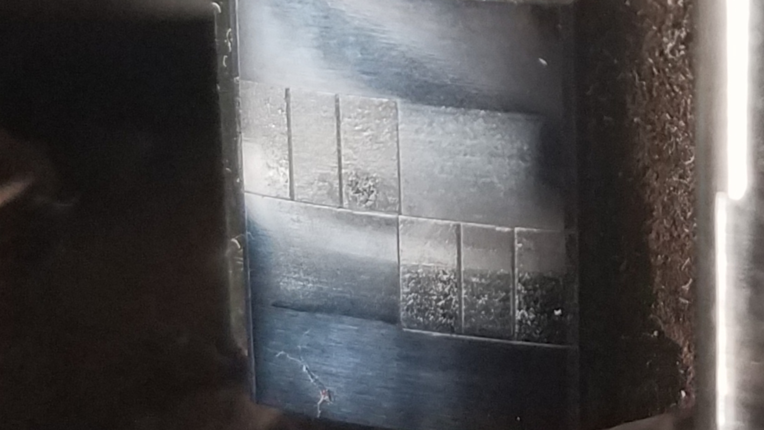

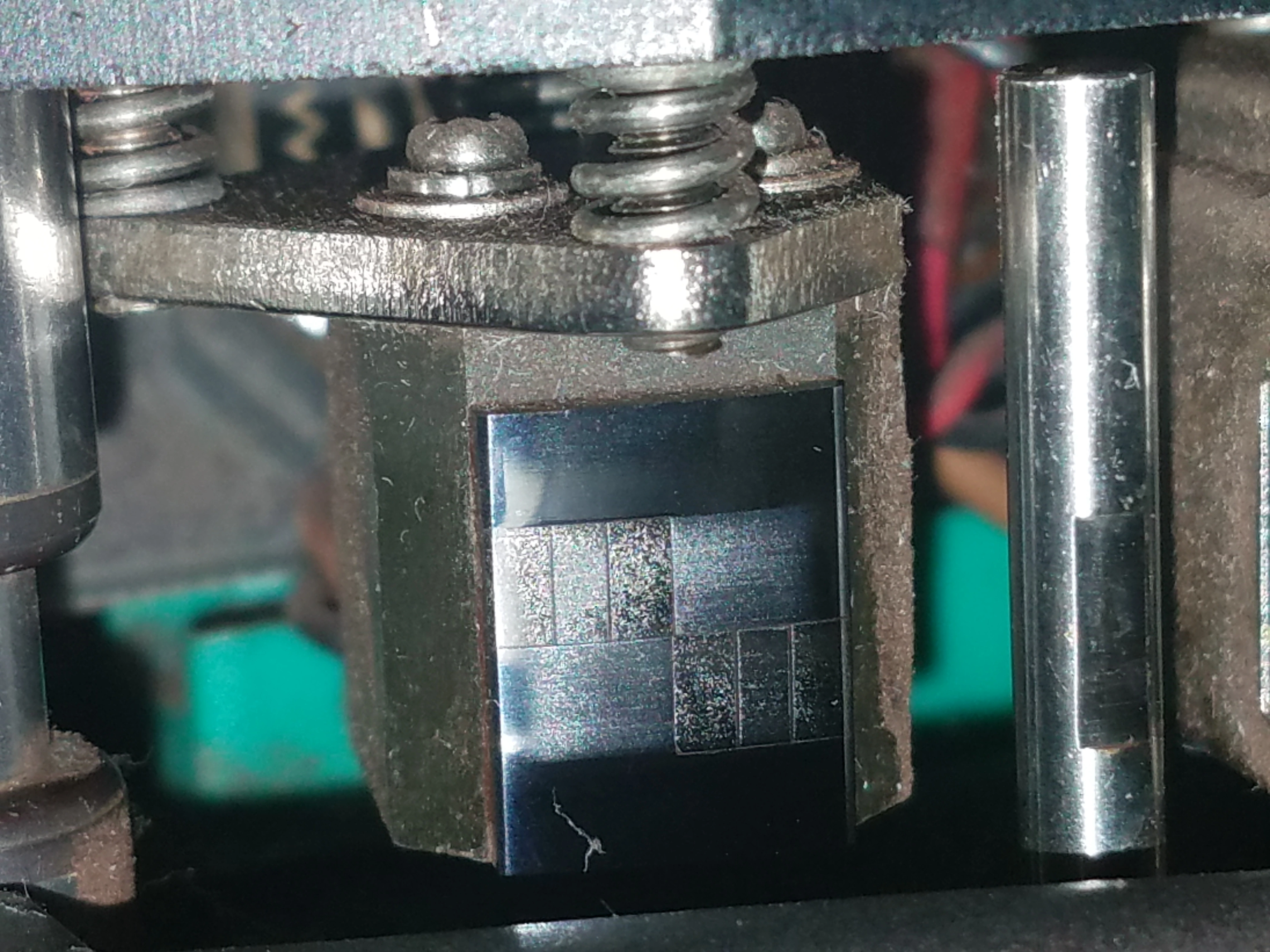

I got some pictures of the head up close. The white part is more of a magnified reflection than anything else. But what the pictures do pick up is the weird speckled almost rust like pattern on the head. That's more of what I was seeing. It's just a little worse on the top so it looks like one spot in person. Is this normal or am I over exaggerating the problem?
They do look a lot more textured than the erase heads I have, but I don't know the 5050 well enough to know if that's normal. Hopefully someone else here has more experience with them and can chip in.

Yes, the heads look fairly worn but the interesting thing is that you appear to have both half track and quarter track playback heads - I don't know how standard this was with these machines. The erase head looks clean to me although I don't know about the texture. Does it play tapes properly?
Standard option from factory. I think Miroslav mentioned recently that he got a Otari 1/2 track that had 1/4 track playback option, it can come in handy.

The goal is to get the guides (at least the really badly worn ones) turned to a good spot before the tape gets here. The guide right before the erase head is worn a lot more at the top than the bottom which is what really made me want to get the guides rotated before playing tape on it... not that one tape would matter that much. I figure now is a good time to do it while I'm fired up about having the machine and no tape to play.

If the guides aren't evenly worn from top to bottom then it is worth checking the whole tape path to see if anything is bent. Bent tension arms are often a cause of this sort of problem.

Ok, the one before the erase head was the only one with serious uneven wear in my opinion. The one before the capstan looked a little but I'd think the arms wouldn't affect the wear since the capstan is in fact right after that guide and the first thing before the erase is the roller that generates the time for the counter. Is there a standard method for checking the guide arms? I dont thing it'd be easy to put an indicator on.
Also all the guides have been rotated now. The methods and work required took a bit so I'm thinking of posting a how to when I get a chance to set down and put up all the pictures and stuff.
The wear I was talking about should be clear in the earlier pictures I posted. You may have to zoom in a bit though.
You were spot on. After just visually inspecting the arms, I found the one before the heads was quite bent. So I carefully straightened it while comparing both sides to a steel ruler. After putting the guide arm back on the machine I noticed the tape was right in the center of the guide as opposed to rubbing one side.
So thanks! I would've probably never noticed otherwise.
