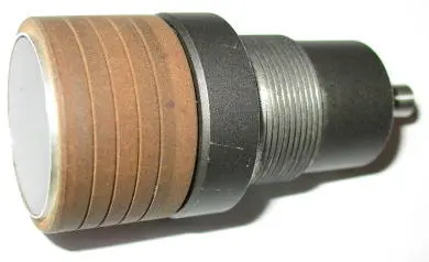

Does it look like this?
You could get some 400 grit sandpaper and very carefully and evenly resurface the roller..
Just roll it a few times across the sandpaper with medium pressure on the roller..
You could also increase the back tension on the take up motor...
Yes, it's that part. I figured I might get to that point before buying a replacement, but I'm budgeting for it over the next few months. That was a standard field technique for taking the shine off of capstans, though I think the recommended technique is to gently slide the sandpaper parallel to the axis of the roller and along the surface.

My belated thanks for the tip! A quick update: I got some fine sandpaper and scuffed the surface of the tach roller today and now it tracks rewind perfectly again. I used very light pressure, rubbing across the surface from the bottom edge to the top edge of the roller (parallel to the axis of rotation) and just slowly rotating the roller around to work on a new area until I went all the way around a couple of times. That is similar to the technique recommended by Ampex for roughening up the surface of a shiny capstan. Sure beats having to buy a new roller and pull the machine apart to replace it (or pulling the machine apart and leaving it out of service while I wait to have the roller rebuilt)! I hope I can defer that job for a while!
