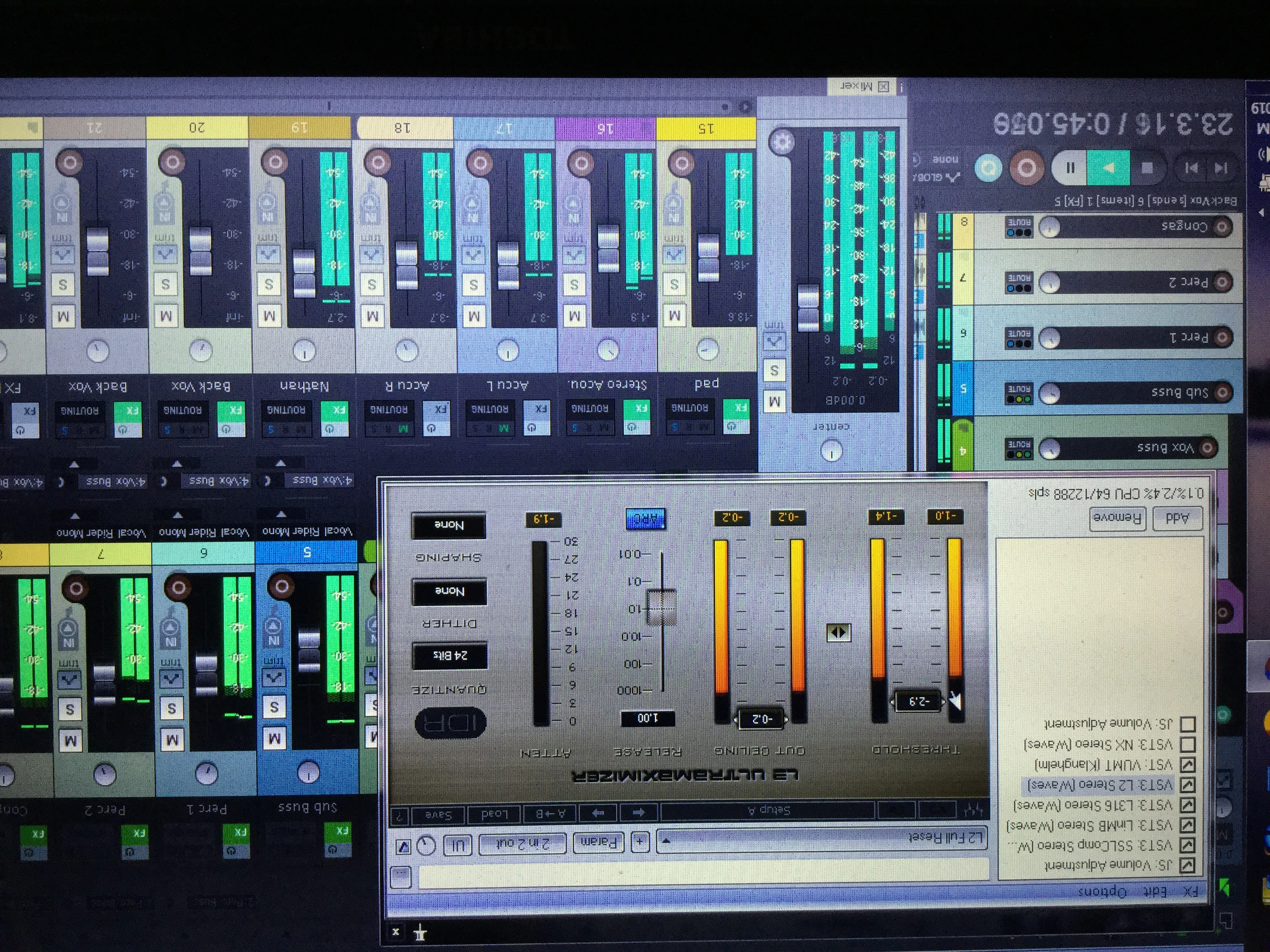

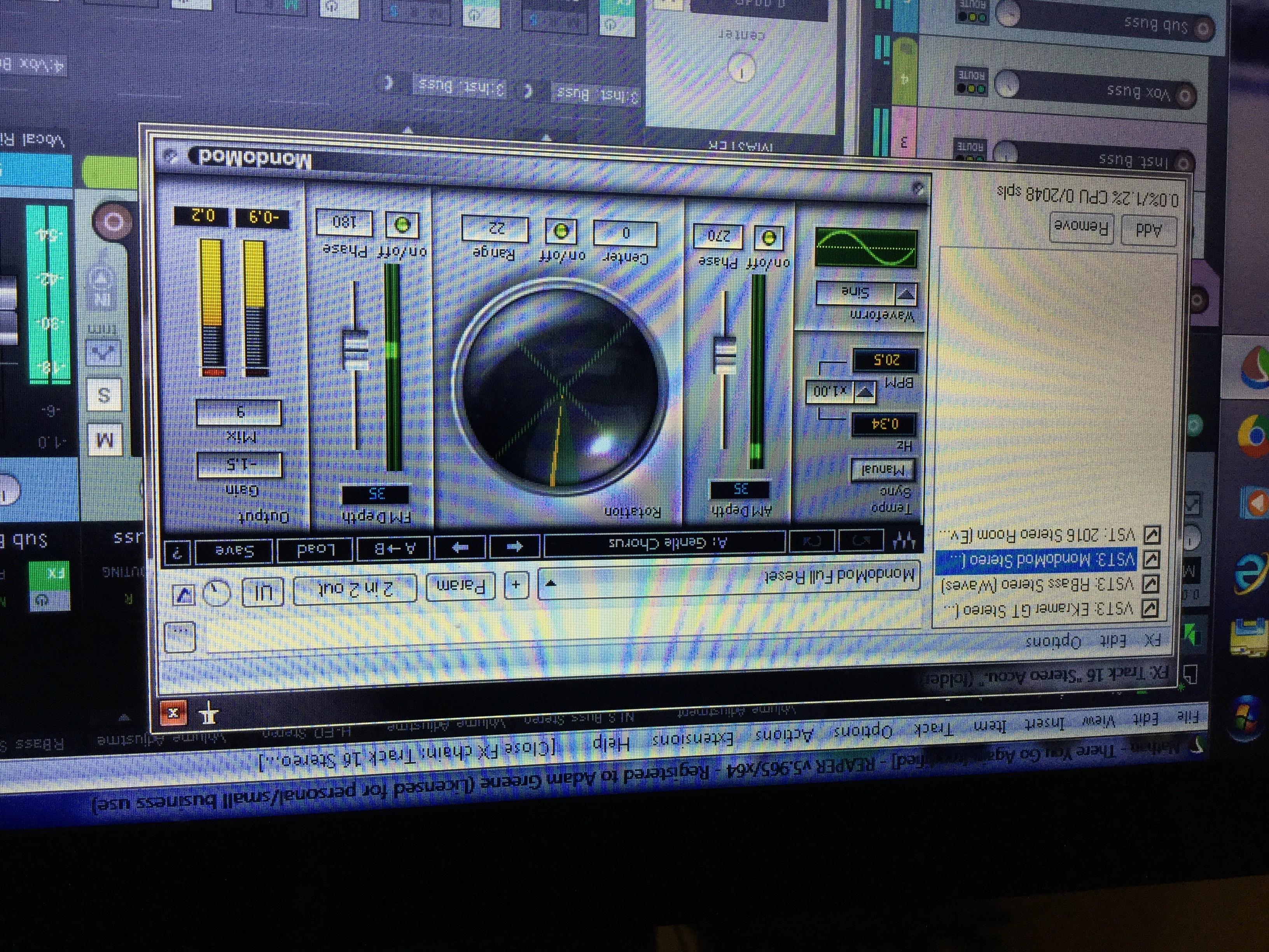

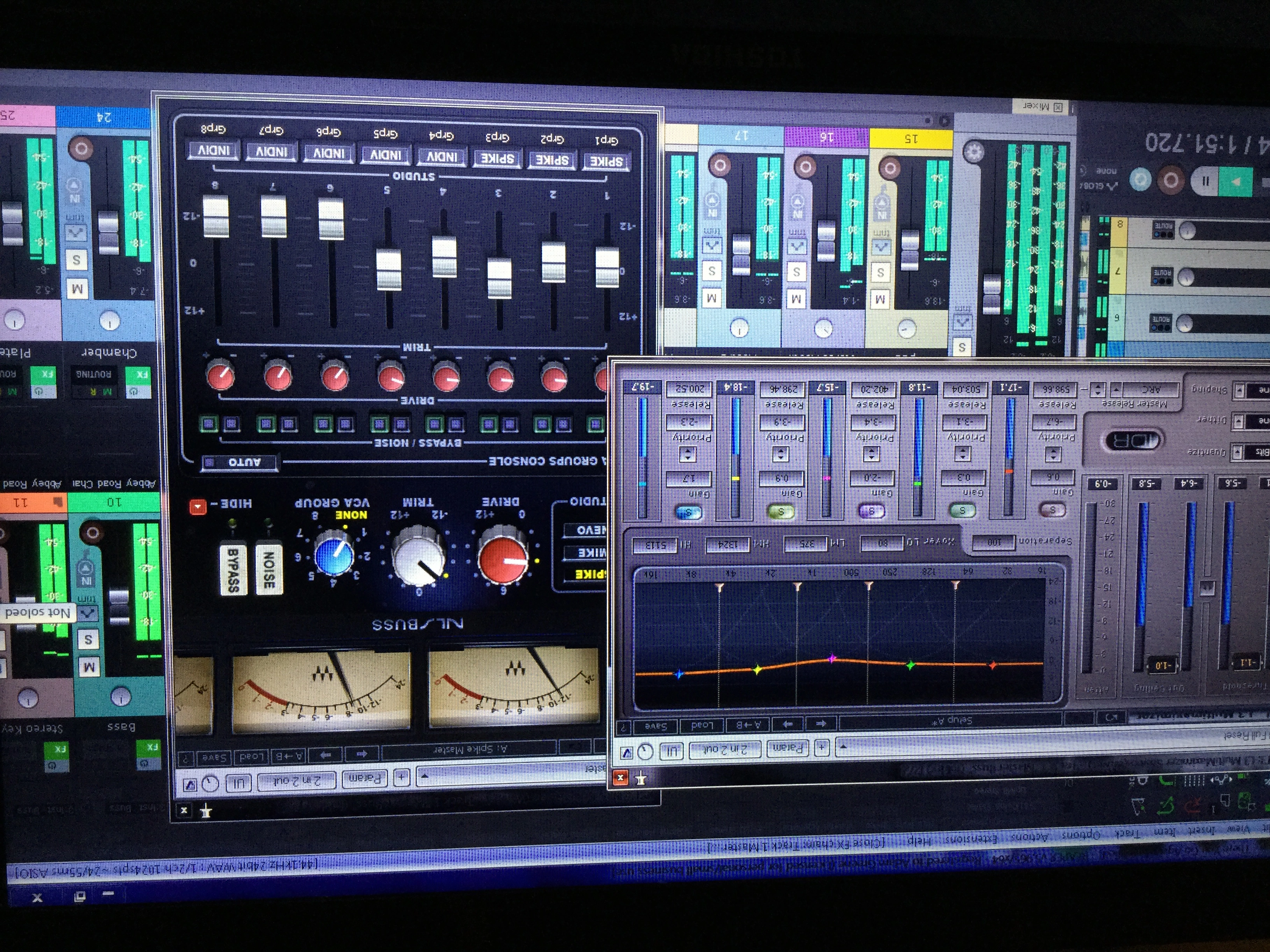

I hope I did this right. But I tried to take some pics and attach them of a small mix I'm working on. 14 recorded tracks and 27 total tracks.

Wow! Can you actually hear what some of those are doing? I've probably just lost touch with some styles that need this much processing.

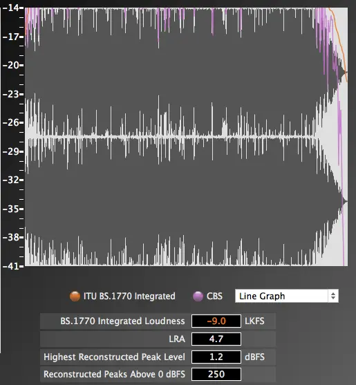

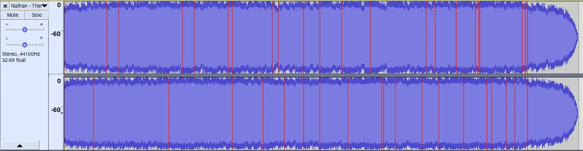

And, what you've made here is what is sometimes referred to as a sausage. The loudness wars are over, man. You've crushed some of the life out of the mix IMO.

You should be finalizing that mix to about -14dB (LUFS) or even less if going to iTunes. When it gets normalized down on some folks phones/ipods it will lose a lot. It's even hot for CD (again IMO) for this type of content.

It's not just the peak, which you've exceeded quite a bit, but the compression that's overdone here.
I'd start by taking all FX off the master bus (ok, if you must, a little "glue" compression, no more than say 2:1 and maybe a dB makup), so you end up with a more dynamic mix. Then, get that so when you bounce it down to non-lossy stereo you've got at least 6dB left to play with before you crank it up to a finalized/pseudo-mastered version, doing that in a separate project, applying your limiter to raise the average loudness (use a loudness "meter" plugin - probably in every DAW by now) to your target. I set my hard/true peak limit at -0.5. When it's converted to lossy format, it almost always pushes it another .1, or you can normalize to 0 in that step if you must. (I don't think the vast majority can hear the difference in a mix that's limited at -0.5 vs. 0.0, but there probably are a few.) Anyway, the point is to finalize to a consistent loudness, and not a peak. If your loudness is achieved while your peaks are at -2.0dBFS, you've probably overcompressed everything from the gitgo, IMO.
