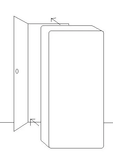

"opening the door and placing the matterss inside the door frame where the door would normally be if it were closed" Dont think a mattress will fit into that space though. If it does, GREAT, if not lay it against the open door frame like the pic. Obviously you'll have to work out a way of keeping it from falling.
