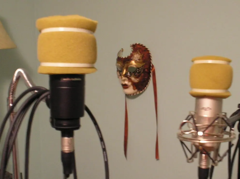

It's just a habit I got into. You know, the more is better mentality. I'm probably way off. A pro would never use two mics, right? Here's what I use.
An Apex 435 and a ST2020 both cheapos but I'm getting a decent sound.
No room treatments or carpet on the hardwood floor. (A real no no)
