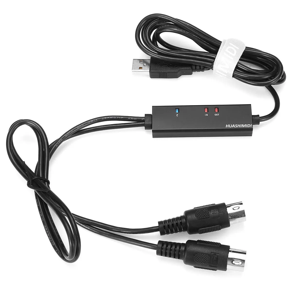

Surely it would be simpler, quicker and about the same cost to just buy an interface with DIN ports?
The Behringer UMC 204HD is very good for the money (see my short report in 'newbs') but I did not check the MIDI side for latency. Most modern AIs are very good these days though.
Beware 'MIDI' on old keyboards? Some, Yamaha for one, did not implement MIDI fully and so play the wrong notes when triggering an external sound module. Hilarious but not very useful!
I understand they can be 're-mapped' but I ain't that smart!
Curious, my DX7 and all my Yamahas since have never done anything strange at all?
It is an interesting way of spending your time.
But you would simply be replicating this:
