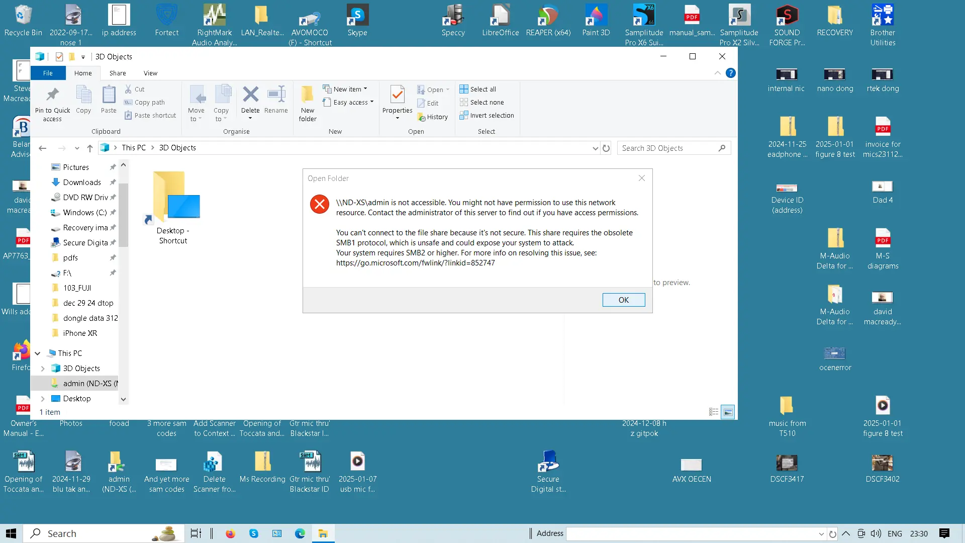

That is what I get when trying to access an old NAS drive in win 10. I can use it in w7 but the setup is very slow. I can access the drive's info from my router but don't know what to change or if a fix is possible. Yes there is a microsoft link I can try but they are almost always a chocolate teapot!

There are instructions for enabling SMB 1.0 in windows 10 that you can try.
  1. In Control Panel, select Programs and Features.
  2. Under Control Panel Home, select Turn Windows features on or off to open the Windows Features box.
  3. In the Windows Features box, scroll down the list, tick the check box for SMB 1.0/CIFS File Sharing Support and select OK.
  4. After Windows applies the change, on the confirmation page, select Restart now.
Hopefully that's solves the problem. (y)

I did have a look at that but my logic said I was looking for "SMB2 protocol" and couldn't find it. Will try turning SMB1 on.
Thanks chaps.
It sounds like you either need to make the Nas support SMB2 or make windows support SMB1.
The latter is what I've described.

Yes mate, the penny has dropped eeeventually! I have found that "Freecom" are now owned by Verbatim but my model number is not found. Luckily they give an email address so I have asked if the newer protocol is available.

Well, that's the reason I suggested just enabling SMB1 on Windows 10.
It's the simplest of all possible solutions.
Whether your NAS drive would work (maintaining your data) plugged directly into a computer...I can't answer I'm afraid.
If it's a single drive then raid wont be in play but there could be some kind of encryption or other obstacles.
If the NAS offers other protocols that should be something you can find in its panel / setup menus but, honestly, just enabling SMB1 in Windows 10 should be the simplest.
