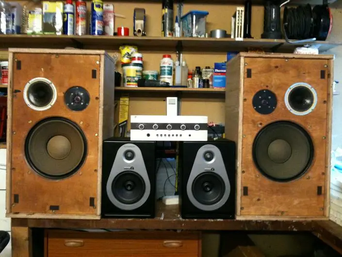

What do you think of my ipod dock?
www.steenaudio.com/dock.JPG
Just kidding of course, Although I'm tempted. :P

I guess I don't see (or recognize) what you're showing me in the ipod pic :(, but I knew those channel strips from the FrankenMacWBamaroo 2012 model looked familiar.
there's an ipod on the amp, as if it's a dock.
