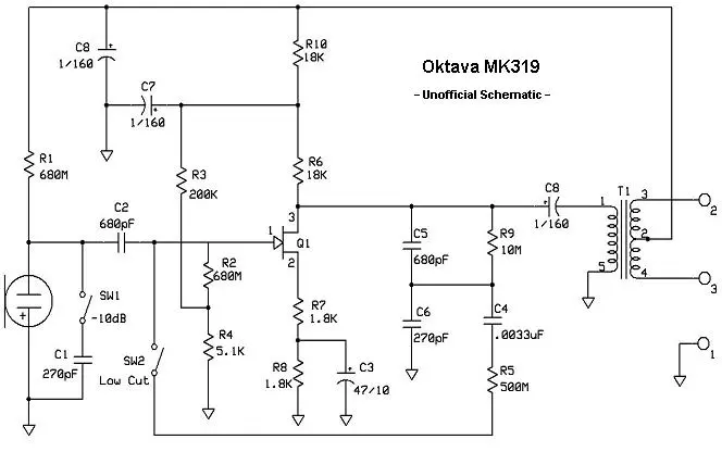

Any links to an original schematic so I can try to figure out what they did to it?

Here's a schematic that I got, I believe, from Flatpicker, who use to post here; I can't verify its accuracy.
