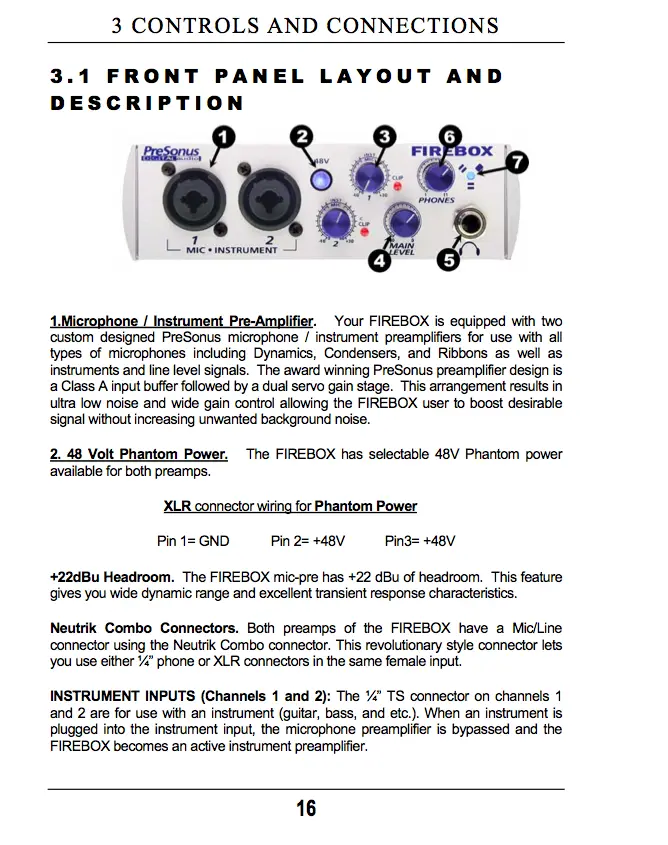

i purchased a firebox and it advertises phantom power 48 volts worth etc. It works with all instruments, except for when i plug in my mxl 990 which requires phantom power. I read somewhere that you cant use a quarter inch adapter so how the hell am I supposed to use the phantom power. do i need some sort of preamp? please help thanks.

No interface will supply phantom power over a TRS or TS jack and there's a very good reason for it.
Preamps and a phantom power supply are built into the interface.
Use an XLR male to XLR female cable.

What??!!?? :eek: It doesn't work with ANY instruments!!! Phantom Power is ONLY for certain mics, like your MXL990. You must use an XLR cable to power your mic. No nothing about 1/4" anything!!! Only an XLR cable to your mic.
El page sixteeno manualo.
holy shit you just blew my mind wow. thank you i thought the whole world was like on drugs im like yelling THATS OBV A QTR JACK WTFoh damn i feel so much better now
