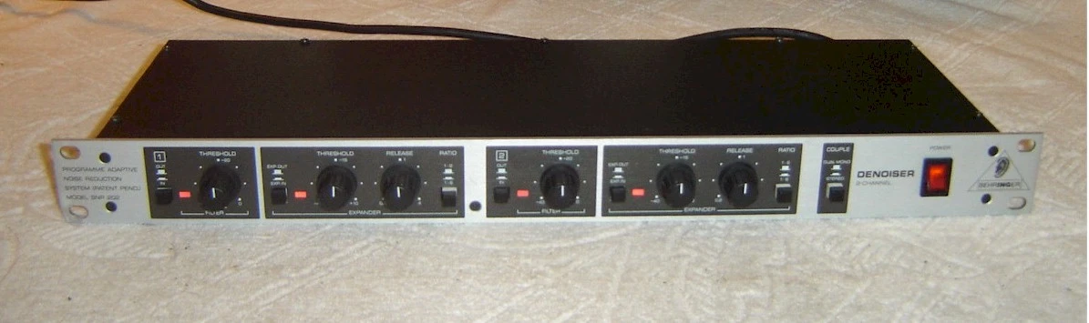

You can clean it up in the analog realm remastering through single-ended noise reduction. IMO one of the best at removing background hiss/noise was the Behringer SNR 202 Denoiser. This is a solid Behringer Made in Germany before they started outsourcing to Asia. You can often find them on eBay, but as always avoid the "Flower Pot Guy." You can either remix your tracks through its two channels to a master recorder... Tape, CD, sound card, whatever you're mixing/mastering too, or you can try to clean up your existing 2-track master by bringing it out into analog through the SNR 202 to another analog or A/D destination. Not sure what other equipment you've got to work with, so I can't be more specific at this point. I still own my SNR 202. It's a keeper!

Suppose I got two of the Behringer units and used them in between the tape and the interface, would that be better? Am I right in assuming that it's better to attack this noise on the front end rather than waiting until the end, considering I'd want to do some substantial compression on some of the tracks?
