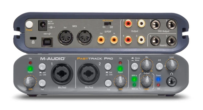

Hope this is the proper forum. First the gear I'm using. Rather give too much info than not enough:
I am using a M-Audio Fast Track Pro with Guitar Rig/FL Studio. I have a Digitech GNX3 floor processor, Crybaby 535 Wah pedal and am using my Strat.
I don't think my amp is an issue here as I've taken it out and still have the issue, but it's a vintage Gibson Maestro with no ground. My floor is all tile and I need to wear slippers and have my pedal on a piece of carpet or I'll get shocked and hear noise. I don't think that's an issue here, though.
Here's what's happening. I got a couple Livewire insert cables today (STP-203) from Guitar Center. When I use it with my Wahwah there's no problem. However, if I plug in my GNX3 I get noise. On some (mainly hi-gain) presets I get a high pitched squeal, but some others it's a lower pitched sound. If I change presets the noise stops. If I unplug anything in the chain or make a sound with the guitar, the noise starts up.
When running the "normal" way (Gtr<->GNX<->FT Input) it sounds fine. It's only when using the insert cable that I'm getting the noise.
I've never used send/return wires before. It works fine for my wah but are they not designed for use with processors? Would a higher quality wire help here (these look a little cheap to me... maybe not shielded well enough) Could it be my pedal, even though it only does it with the insert wire?
I just would like to know before I drop money on a $40 Monster cable or something. GC only had these little cheap ones so unless I find one locally I'll have to order online.
My plan was to use the GNX on one insert and the wah on the other (I didn't know if turning the GNX off would kill the signal... It does. Boo...) Am I wrong in what inserts can be used for? Are they simply for simpler things (tuner, compressor/limiter, mod pedals, etc?)
