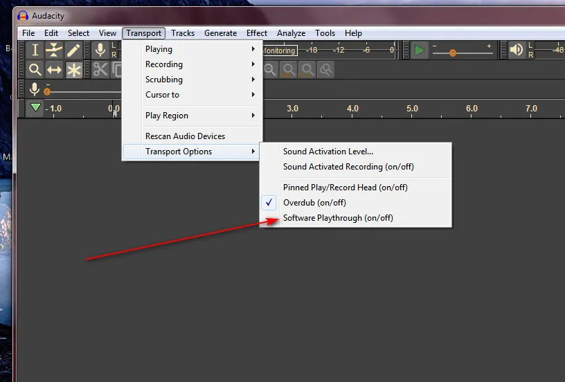

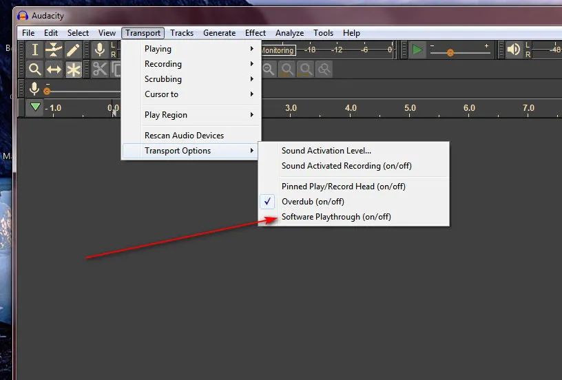

Been a while since I played with Audacity, but is 'Software Playthrough' ticked off? Also 'Click to Monitor' in the record VU meter may affect playback monitoring.
