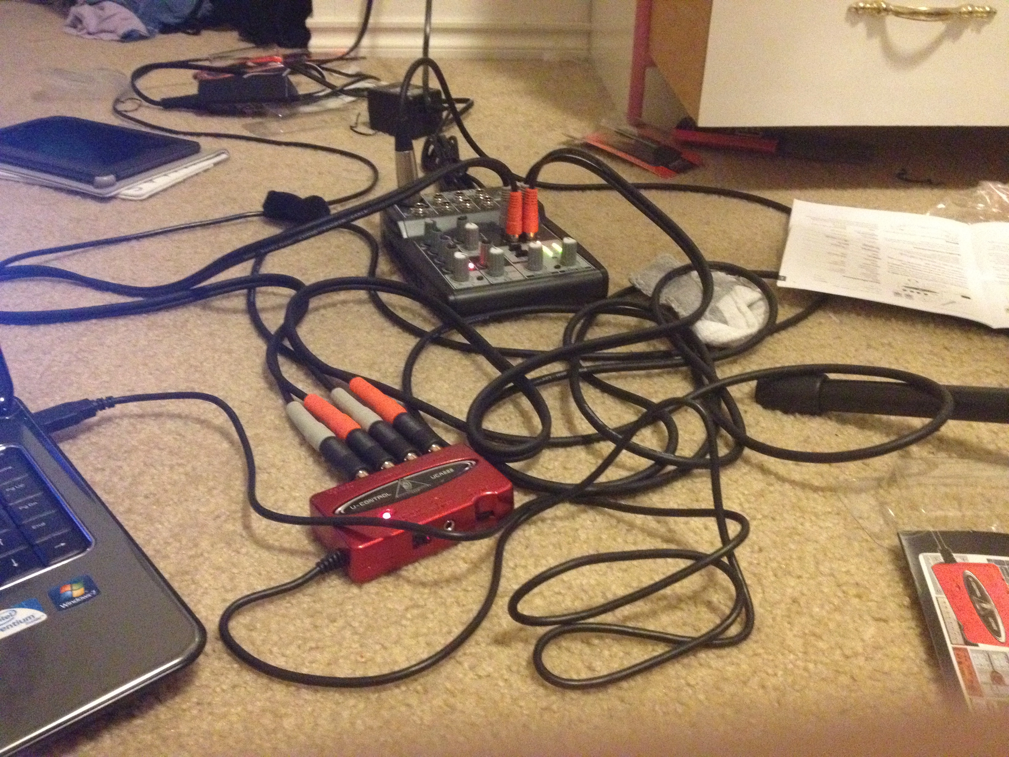

In this case, the OP has already told us he has a Behringer mxer with a single mic pre amp--but there's some doubt as to whether that particular mixer provides phantom.
