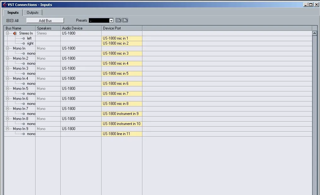

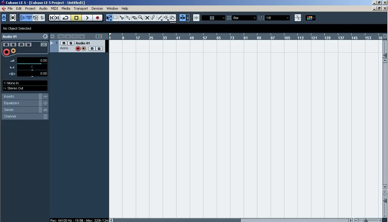

Post a screenshot of your VST Connections window (inputs) as well as the Inspector opened to the track you are trying to record to.

In VST connections you should be able to see all the Tascam's inputs - are they there? From time to time mine only shows 1 and 2 in and out - closing cubase and turning off the Tsacam and back on usually restores access to all the ins and outs.
Jimmy's request is a good one - although if you can see this screen, it will usually show you the problem too. So in devices make sure the Tascam is up and running and in connections set the input to 9 or 10. I can't think of anything else that would prevent it working. The headphones can hear the computer output or the interface output - so that doesn't help too much.

In the Inspector window (far left of your project window) select 'Mono in 7'.
On the thing that kinda looks like this: >]
Right now your screenshot shows 'Mono in'. That seems to be your problem buddy.
You must select the correct input bus for every channel you wish to record to. Say you used 3 mics and a direct input. You would need 4 mono tracks, each of them assigned a different input bus. Each corresponding to the input bus named in VST Connections.
Wow, that worked! May I ask why Mono 7 is the one and not mono 9 (the actual in I am using for the guitar?)

It just depends upon how you name them in VST Connections. You can edit what they are called. Name one 'FART' if you want.
Looks like you used a default setup so the first bus is a stereo one, so that took the first two inputs and made the numbering off.
Just delete the stereo bus, and set your mono input buses to the correct inputs of the 1800. Then 'Save As Template'. Open this each time you start a new project.
