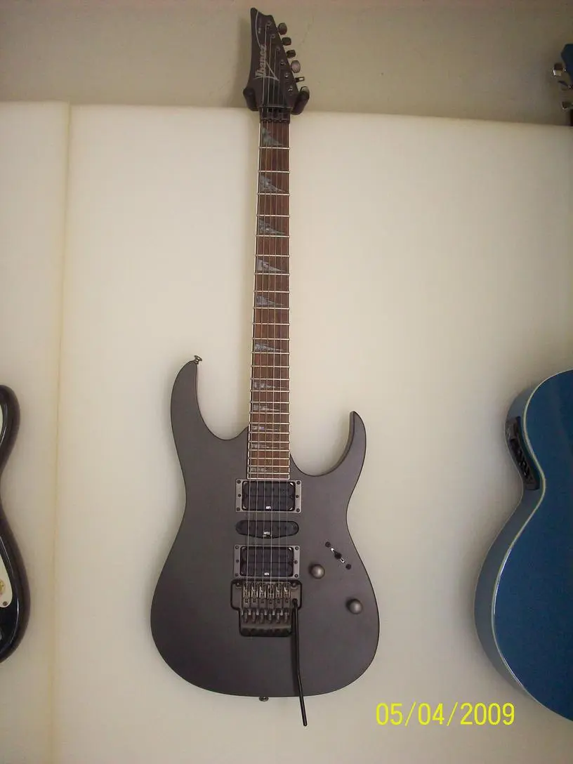

After buying a new (to me, used) Ibanez RG5EX1, I decided to set it up myself for the first time. Previously I owned a Jackson PS4, and had it "professionally" setup.

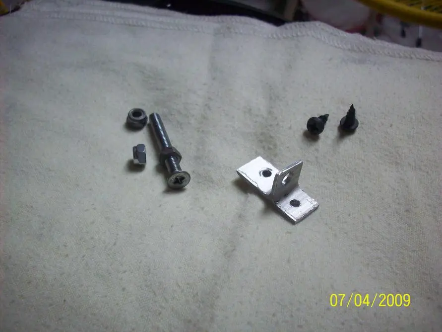

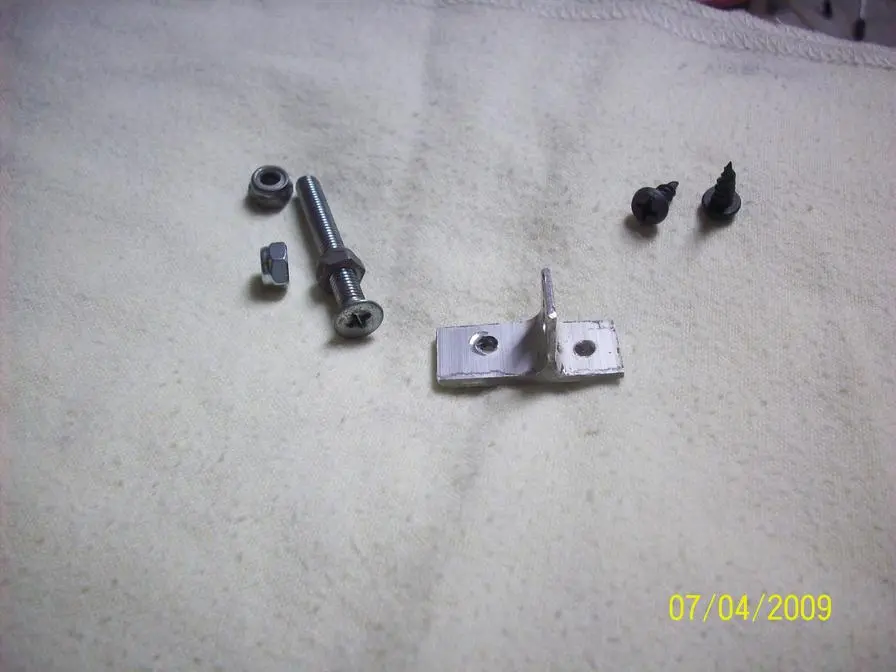

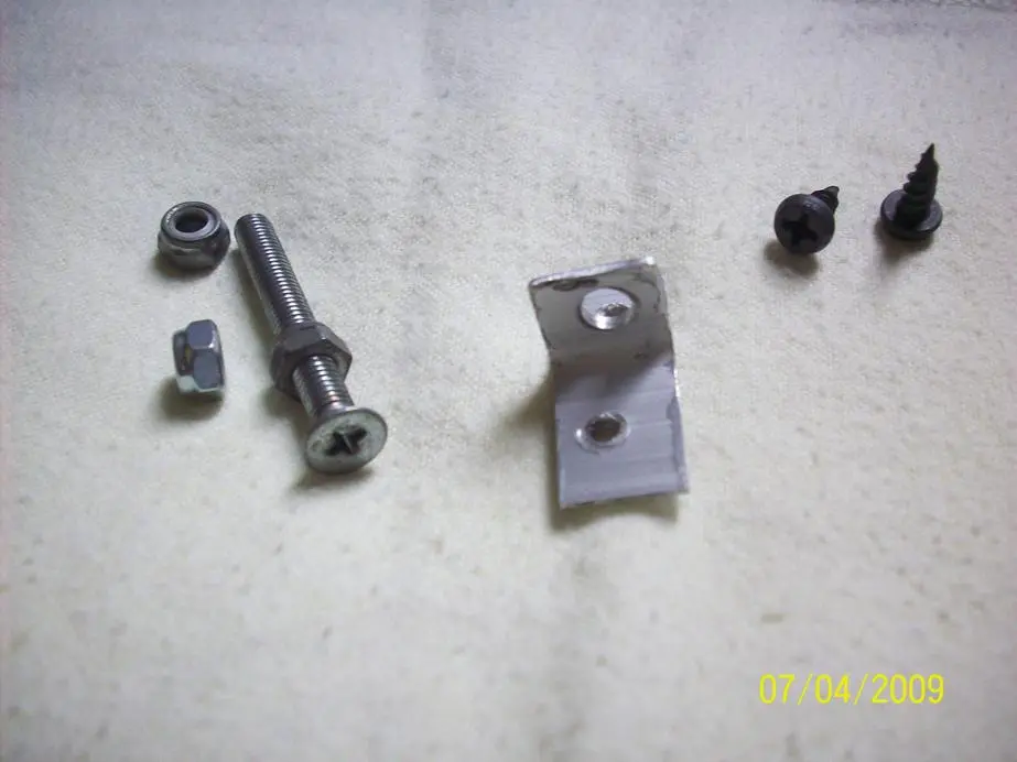

First, the materials to use:
1-Metal L bracket (in my case, I used an aluminum railing leftover cut to size)
1-1 1/2" bolt type screw
3-"Nylock" washers to fit the screw mentioned before
2-Drywall small screws

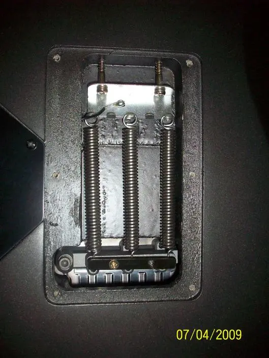

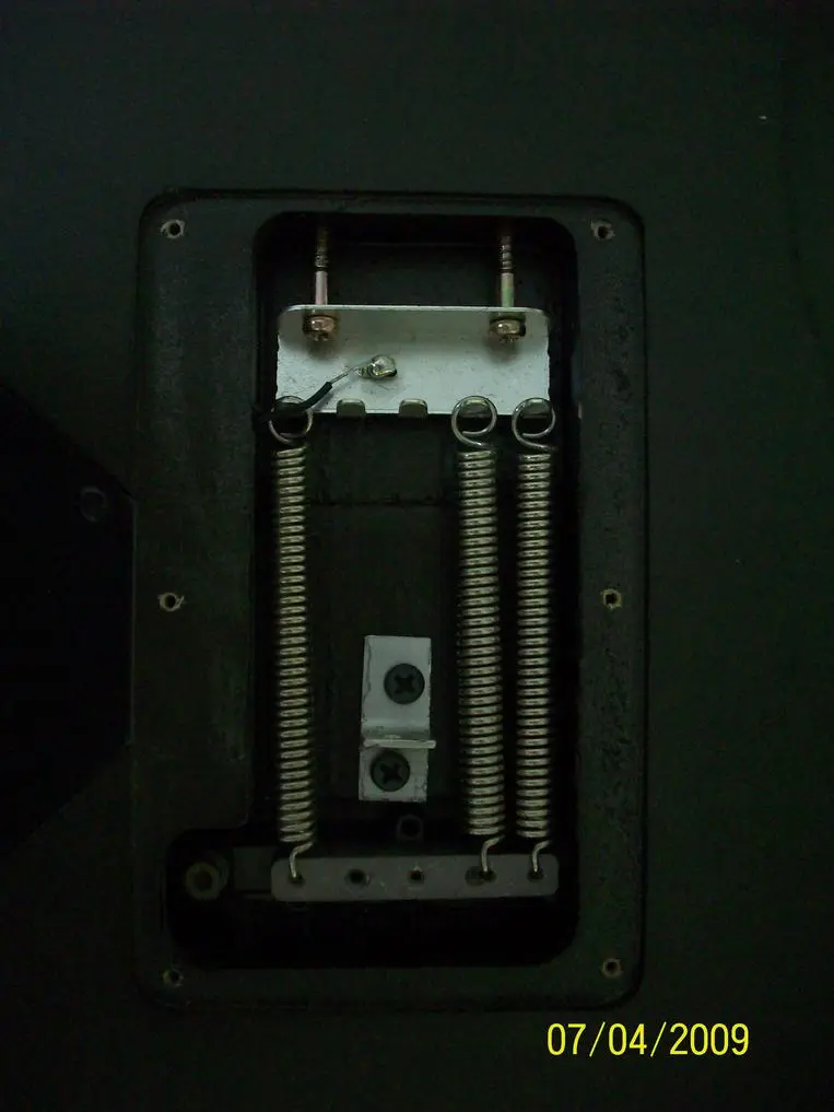

Here, have some pics:)

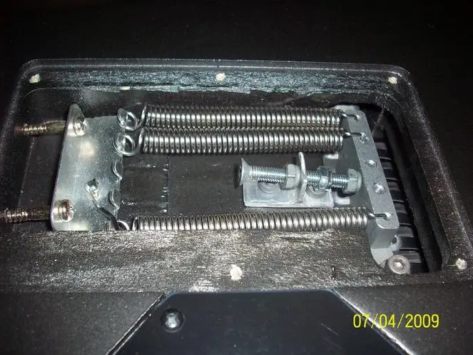

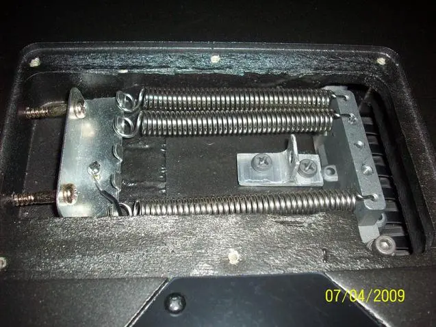

Procedure:
I'll let the pics do the talking!

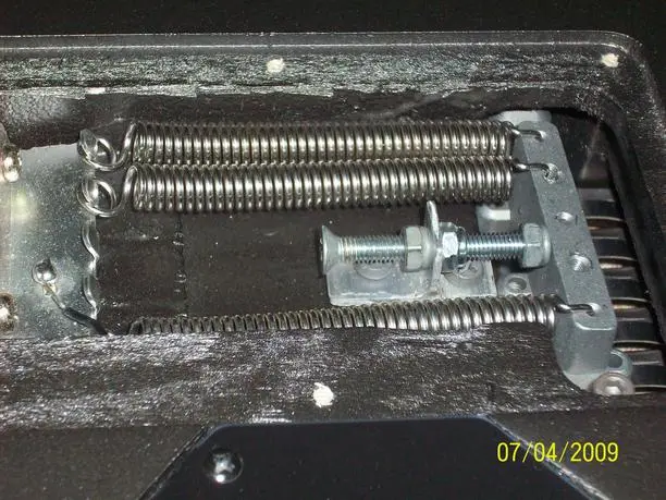

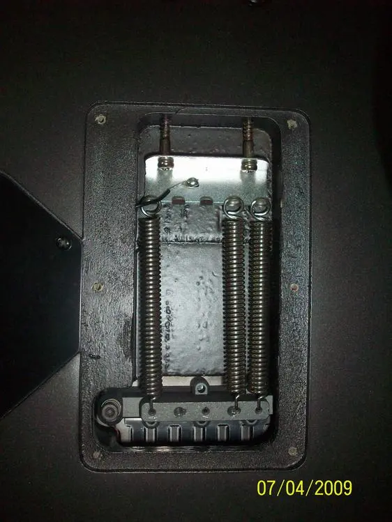

Then I just had to set the boltscrew in place (I don't know if this is the correct way to describe it, but I guess you get the idea:D)

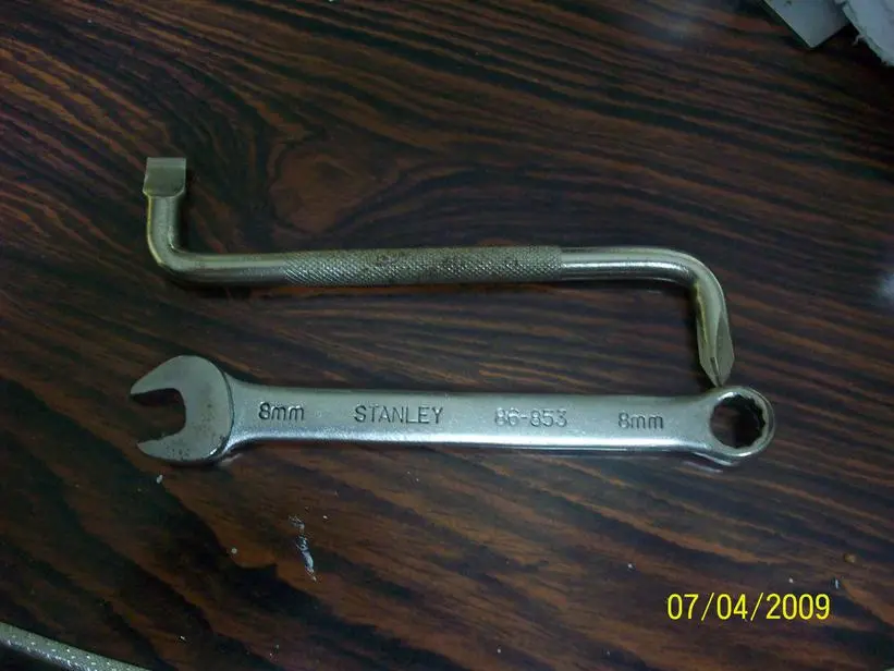

Tools needed to adjust the stopper screw:
An 8mm wrench
An angled philips screwdriver

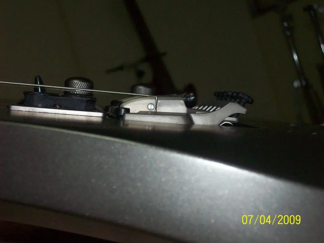

I'm really happy with the results; I can bombdive and I know my bridge is going to always land where I want it...even better, I can make it a floating bridge again with the turn of some bolts:D
