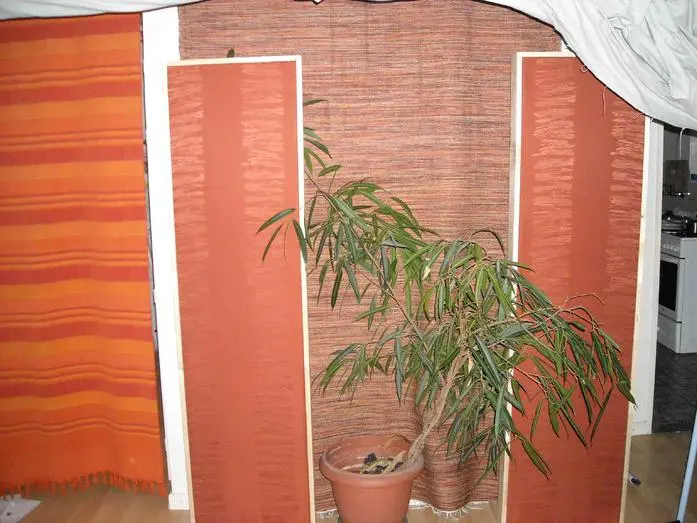

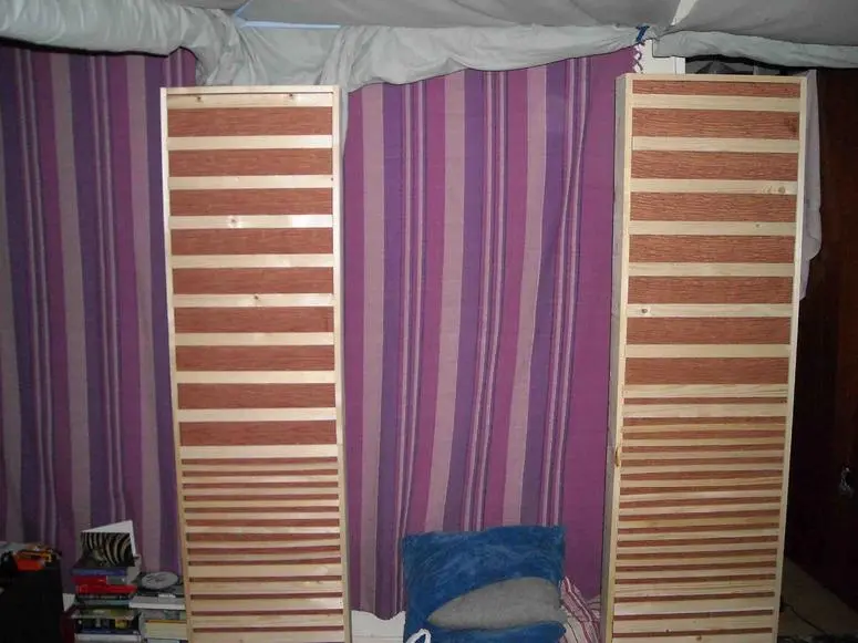

i got this recording here at home in my livingroom...fixed the acoustics here...fairly dry.
recorded everything closemiced, so no room mics. i setup a room mic but it succed.
