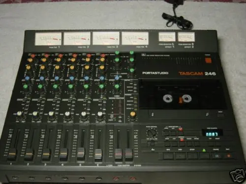

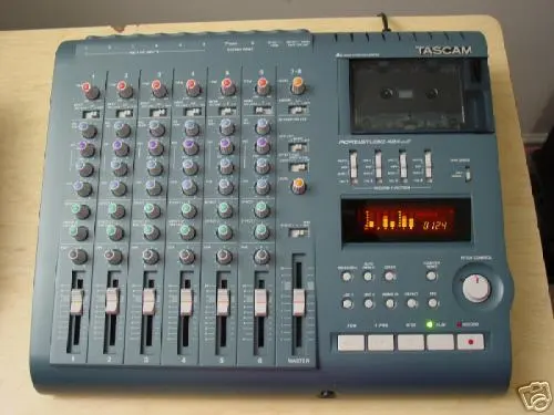

IF you can indeed source either a 246 or a 424mkIII in like new condition, equally pristine machines in full working order, then the clear winner is the 246.
Simple, huh? ;)
The 246 has more high tech built into it than the 424mkIII. The 246 is a 6-input/4-buss mixer, where the 424mkIII is an 8-input/2-buss mixer, with 4-Direct capability. Those are two different design philosophies, right off. 4-buss is a higher tech than 2-buss, and the 4-Direct capability of the 424mkIII only bridges the gap partially.
The thing that the 246 lacks and the 424mkIII has, is XLR mic inputs, but that's a minor issue in the big scheme of things. The 424mkIII also has auto-punch feature that the 246 does not have, but that's a little used option, and doesn't get to the bulk of what you'll be doing or looking for in a Portastudio.
The 246's 6x4 design gives you more flexibility, overall, but granted, the 424mkIII's not too shabby. It's when you want to record more than 4 inputs onto 4-tracks simultaneously, that when the 246's design shows itself to be dominant.
The EQ section on the 246 is a little sweeter than the 424mkIII, too, which is something that will affect your everyday recording experience.
With all other factors being equal, I'd get the 246.
/DA
Tascam 246...........;)

Tascam 424mkIII......;)

Well it didn't take much to convince me. Nice pic of the 246. ANy chnce you'd be willing to part with it?
Thanx.
I'm not selling anything at this present time. You'll have to hit the Ebay circuit.
This one closed on Dec. 30th, and both of us missed it.;)
http://cgi.ebay.com/ws/eBayISAPI.dll?ViewItem&rd=1&item=3771606268
Be patient,... wait long enough, and another fine specimen such as this 246 should float by. Granted, it's harder to find a mint 246 these days, than it would be to find a mint 424mkIII, which is still available as new/retail, for $300 from the likes of www.zzounds.com/a--2676837 .
The 246 above closed for $296, almost even money to the brand new 424mkIII. That's how well these classic pieces can hold their value, if it's kept in mint -enough condition. Keep in mind, that the brand new 246 cost about $1350 in it's day, and it's a heck of a lot more machine in technical terms, than the 424mkIII. Still, this is an example where a mint used 246 bid for even dollar to the brand new 424mkIII, which should make most of us pause to think.;)

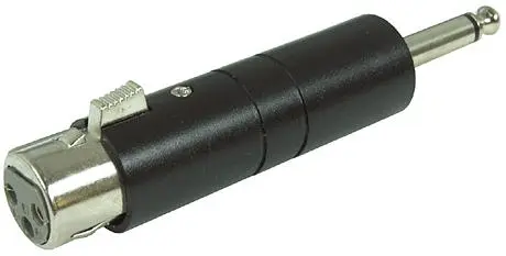

In case you missed one of the finer points of Portastudios,... the 246 has a built-in 6x4 mixer. If you want to accommodate up to 6 XLR connected mics, all you'd need would be 6 XLR-1/4"M transformer/adapters,... a low cost item (x6). $12.99/ea., at www.musiciansfriend.com , see below.
Not that a Mackie might not be good as a "sidecar" outboard mixer, but you don't need the Mackie, in the strict sense, if you have the 246. The 246 has one of the finest mixers that Portastudio 4-trackers have to offer, built-in.
...Low Z (XLR F) - Hi Z (QTR M) Transformer
Product #330151 www.musiciansfriend.com ... http://www.musiciansfriend.com/srs7/g=home/search/bigpid/base_id/36513/

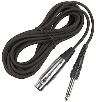

there's a simple XLR(F) to 1/4"(M) cable that would do the trick, for a few less dollars, each.
XLR (F) - QTR (M) Cable
Product #330142 $9.99/ea.
http://www.musiciansfriend.com/srs7/g=home/search/detail/base_pid/330142
Just to emphasize, you don't need the outboard mixer, you just need the proper cables or adapters.
