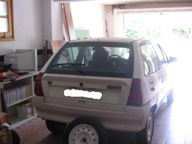

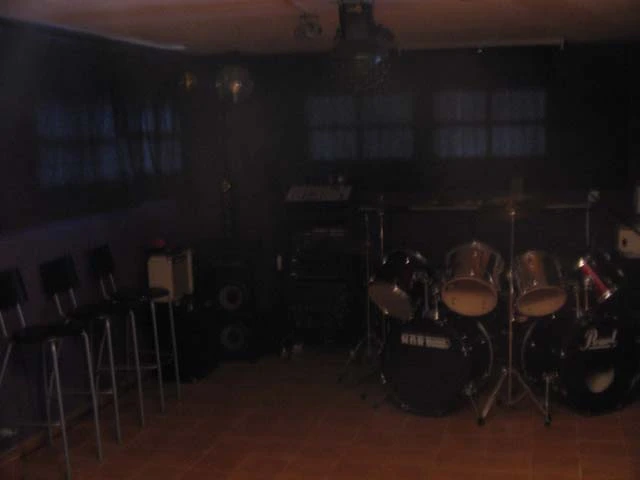

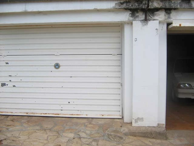

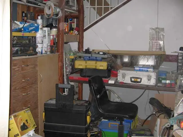

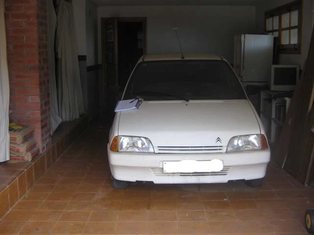

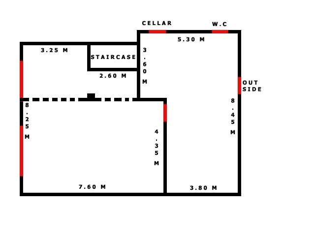

I'm living in a house with a big basement floor (plans of which are attached to the post) which I would like to transform into a nice recording studio. Which would be the first steps to accomplish this? I'm attaching photos too, so you can recognise potential problems which I couldn't, and don't worry about cars or anything, all those are going out!
So, what should I do to make this place a viable recording studio? And which distribution would you recomend me?
Don't get fooled by the blueprint proportions, it's not very precise, but the written lenghts are.

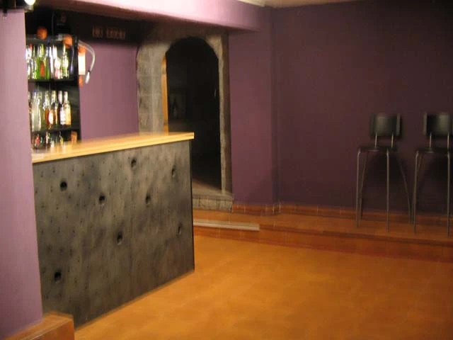

I also thought about not using the right side (as you can see, it is so nicely arranged as a mini disco), wouldn't it be so small then?
Feedback plezzzzzzzzzzz
Thank you so much, and I hope to stay a long time here!
Anscari
1st: The blueprint
2nd: From outside (left side of blueprint, the two big doors)
3rd & 4th: Lower side of blueprint

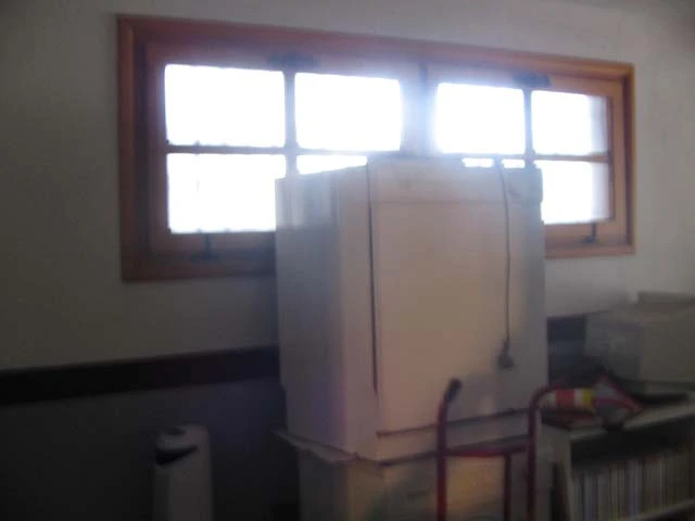

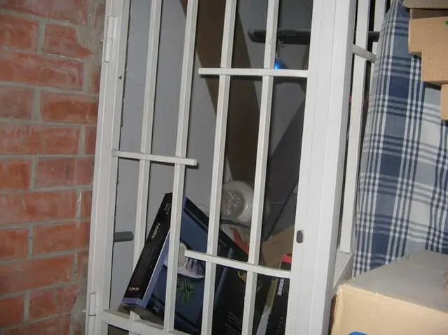

5th: Window detail

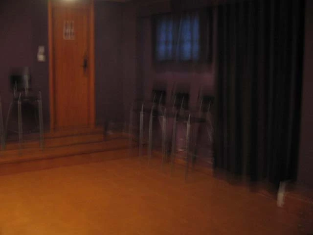

6th & 7th: Upper side and staircase

And the right side nice room

Okay, I am going to refer to the blueprint posted above for my suggestions. This is just my opinion, so yeah. First, I would make the room in the bottom left of the blue print the tracking room because it is far away from the wc, and the sound of water going through pipes can ruin a recording way quick. that being said, the window in the room should be either treated or just blocked off completely (though you should be careful blocking it off completely because that could create a resonating cavity, very bad in this case). Also, if the dotted line on the top of that room is not a wall, put a nice thick wall there. At the bottom of the stairs, create a soundlock to prevent any noises coming from the stairwell getting into your recording room. That is how I would do the layout. Treatment is a whole other issue that i won't get into yet. First, I think I would like to hear what others suggest about a layout. Is this building in a crowded area or connected to other houses? that could create some problems, especially if you need to do isolation work in the rooms first. That could eat into your space and budget pretty quick.
It is an isolated house, and there's no one around the house except in the night.
I have pretty much decided not to use the big room in the right side, so I think that the W.C. isn't going to be much of a hassle...
The dotted line is to show the little slope which you can see in the second photo.
What do you mean by "blocking off" the window, and how can I avoid it creating a "resonant cavity"? I think that I prefer keeping that window for having a bit of natural light, if it is possible, I guess that's what I could get by "treating" it as you say.
The staircase has got a door upside, would it be of any good to put a soundlock up and another down? Will I get rid of problems with it by just putting bricks in the part which just has the metal railing?
So much little things with that space, isn't it?
Okay, time for round two. You can get by treating the window. This would be done with either really heavy, thick drapes or you could make a kind of acoustical "plug" made of mineral wool covered in fabric. The thing is that windows are bad when it comes to acoustic energy. The plug or curtain will make it so that the sound in the room doesn't get reflected back in from the glass. If you need to keep sound out of the room from outside, then that is a bigger problem, but we can cross that bridge when we get to it. As far as the room on the right side, I would think you could use it as a control room if the walls facing outside provide enough isolation. I would wall off the top section, creating a little room outside the cellar and wc doors. This wall would NOT be parallel to the wall on the opposite (bottom) side of the new control room. This is all assuming you want a control room and assuming you can put in some kind of heavy window in the wall between control room and tracking room. Would you prefer to record in the same room as playing? If so, then I am making a moot point.
What are your walls made out of? You may need to put up an extra layer of drywall or something. You definitely should put up a wall where the slope of the floor is. You can put a door in that wall, and try to make the wall not parallel to the opposite wall to avoid standing waves. It should be a strong wall, with a couple layers of drywall at least on the studio side and filled with good absorbing material like mineral wool. What kind of floor is there?
I see your points, and that's so useful.
I don't want to use the right side room, at all... Mainly because it is a part of the house which is quite used, unlike the other space which is completely abandoned, but also because it is the worst part of the entire plan when it comes to "sound" (very very thin walls, a lot of windows, etc...).
Si I guess I could make it without it, in this case, I have even thought about not using the upper part (the one in the slope), but I've been using sketchup, and I get a TINY space which probably will sound like crap, so I think it's not a good idea :D
I don't understand your question about "recording in the same room as playing".
It's ceramic floor all over the place.
Do you want to have your recording equipment in the same space as the one you will be playing in, i.e. will your guitar and amp or drums or whatever be in the same room as your computer or other recording device?
No!!!
I want to have both a recording and control room... as I have space for both.
Okay, then here is my suggestion. If you aren't going to use the right side room (as shown in the plan view above), then your control room is probably best going to be located in the bottom right corner of your main room. Do not make it rectangular. From the top it will look sort of like a diamond with five sides. The two existing walls will make the point and then there will be three others. One will face out towards the corner completely oposite it (top left) and the other two walls will then connect that wall to the existing walls. These walls (all 3) will need to be very thick. You will also want a large window in the center wall looking out into the studio. Do some drawings to determine the right dimensions so that you have good sightlines into the room. I think that should cover the basic layout. Make sure you have patch panels to run cables from the studio into your control room and make sure that you have lots of power outlets. You are going to need to treat the walls both in the control room and the recording room.

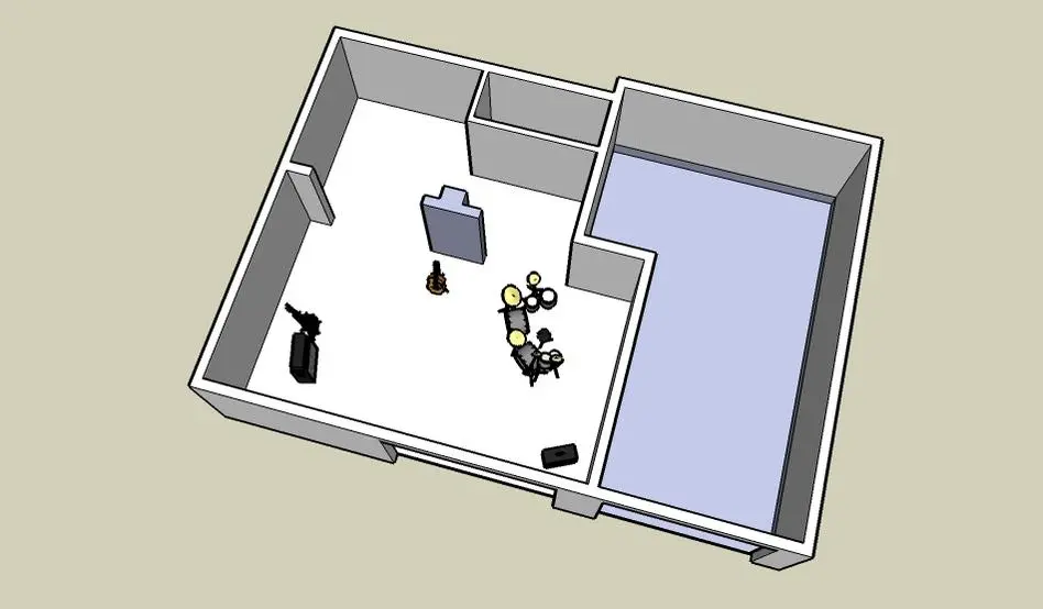

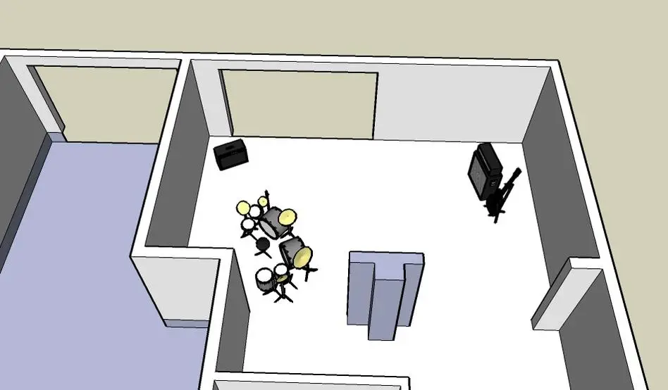

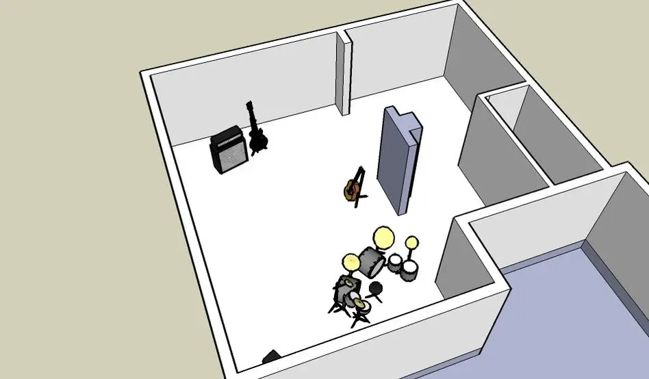

Ok. Gotcha. So...now lets put this into perspective. SPACE ALLOCATION WISE;) We'll go from here.
fitZ
