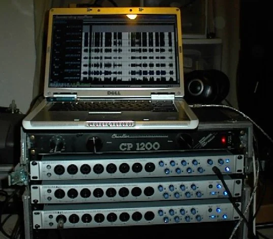

This is my newest Presonus rig for doing small mobile recordings: A Firestudio and two Digimax FS's so you can tell Im a presonus fan :)
