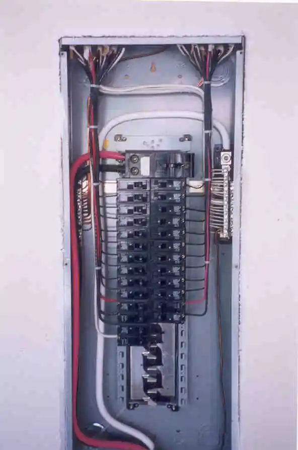

Sure, you're welcome.
The spaghetti.... the wiring you buried :-D
I used to be an electrical contractor many moons ago... I get hives when I see wiring like that. Not that there is anything wrong with it - there isn't. Just reminds of me many jobs I did for customers that kinda sucked heh-heh.
Thats all, nothing was meant by it.

frederic said:
Wiring by an anal retentive:
lol yeah... I studied in electrical engineering so I had to do alot of "perfect wiring" stuff =) Not house stuff but more printed circuit stuff.
^^ and lol about that microwave.
I was noticing the wiring too. That pic you showed wasn't anal at all. Just a damned good job of wiring.
As for anal: My current home, I rewired the breaker box, Brady labeled each lead, split, and end point. The home owner's association somehow got wind that I was doing my own electrical work and requested an inspection report. After much yelling, I had a buddy (who's certified) come out and write up a report. He took one look at it and told me that if I had that much time on my hands, I seriously need to get a better hobby.
Neatness with electrical runs is a pet peeve of mine.
