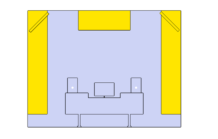

what are the thick yellow block on the side? best bet is to make the corners of the room deep and wide where possible to get the most bass trapping. wall-ceiling/floor-wall/vertical corners work for bass trapping with tri-corners being the most effective spot (in most cases). then add a front absorber, side, and ceiling at first reflection points. 2" or 4" with 4" being a better choice in most cases. on the back wall add another absorber or two to reduce reflections off the back wall.

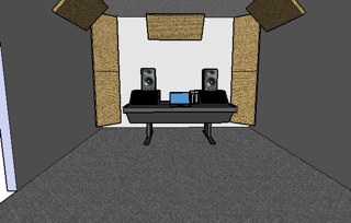

the big yellow things are the top view of the ceiling/wall corners being straddled by a piece of 817. thanks for the input. maybe this view will clarify..

I bought certainteed condensed f'glass for my studio, and I was assured at SPI that it was the equivalent to 703. It's a matter of the pounds per cubic foot or something, not the brand name. I say buy the JM stuff and get on with making your traps. :)
817 I believe is a substitute for OC705. JM 814 is the sub for OC703. The 3lb (703 or equiv) will be about half the cost of the 705 or equiv. ie - 6" of 703 will be 75% of the price of 4" of 705 and work better in the bottom end due to increased thickness.
Gulfo is right on about the corners and the rear wall being 4" thick - or more.
Bryan

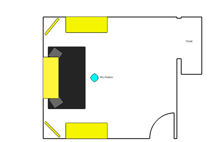

cool, thanks for the info guys. i will at least double them up to 4in. is it ok to just leave the foil backing on and just put it toward the wall? here is another drawing, sorry so small, there is a file size limit on here.
google sketch up rules!!!!

do i have to remove the foil backing, or can i just turn it toward the wall?
The foil will actually make it better as a bass trap, but it will obviously reflect high end. Having it facing the room is supposed to be best, but maybe turning it toward the wall will be a good compromise. A little better low end absorption and it would absorb some highs too.

If you're going to use FSK, have it on the side facing the room for non-reflection point applications. Peel it off the other layers. Having it on the back side facing the wall will give you no benefit.
Bryan
