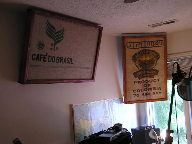

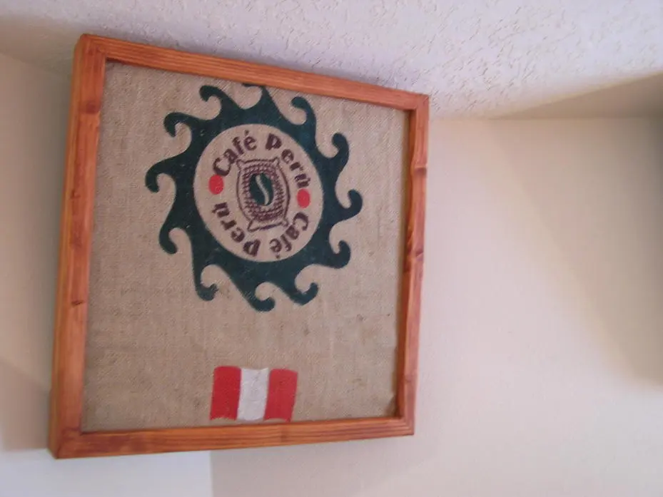

Also known as mineral wool. It's cheaper than the Owens-Corning 705 stuff but just as good for sound absorption. I just made some wood frames and covered with burlap that I cut from old coffee bags that I got for free down at the local coffee shop. They actually look pretty cool and were ultra cheap. If I think about it, I'll post some pictures. I think this will help your recordings.

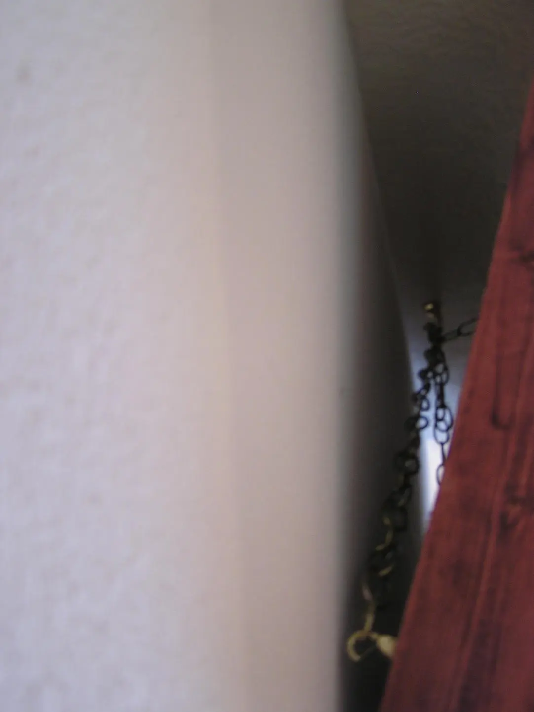

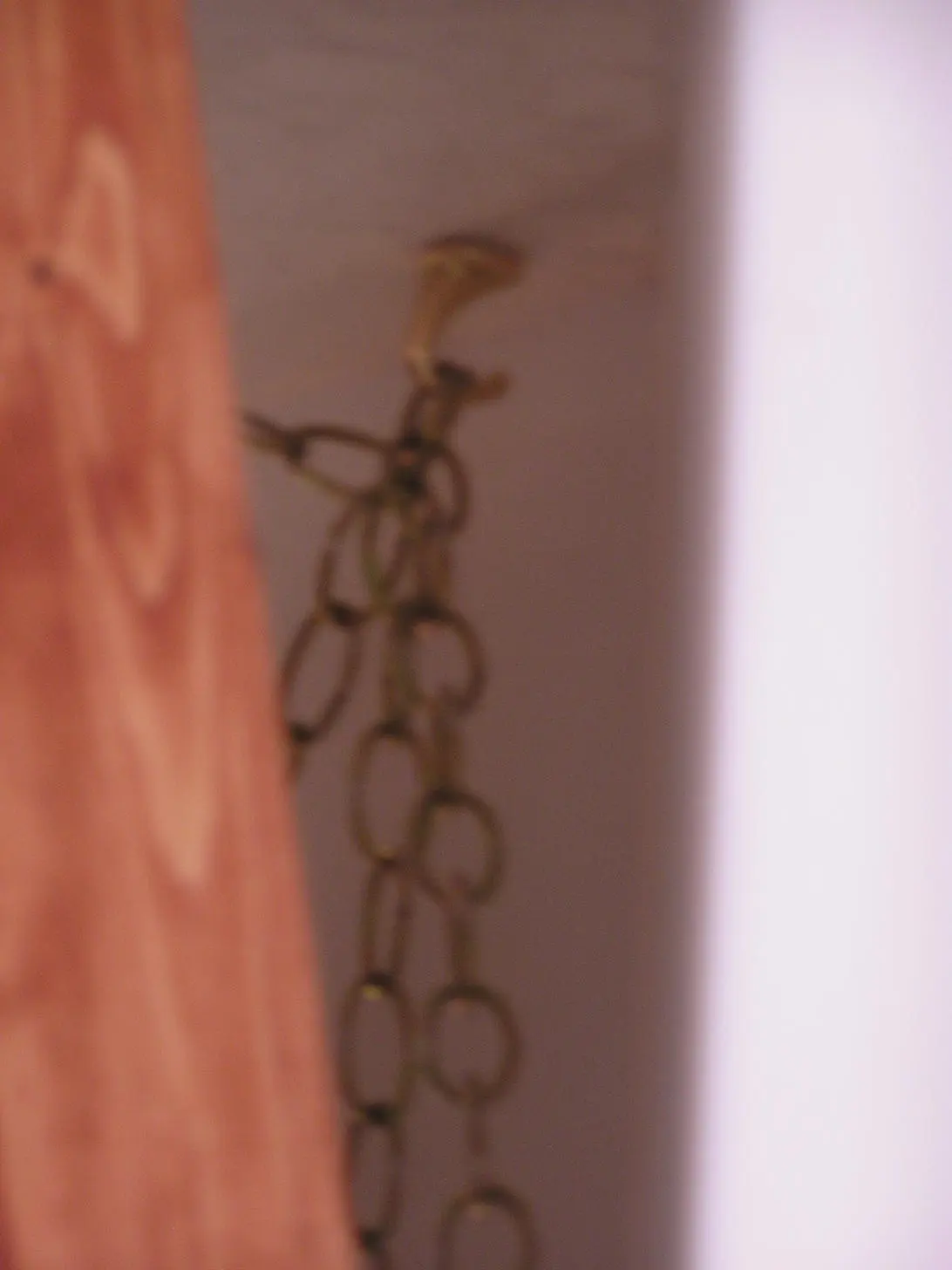

The burlap is glued on with a spray on adhesive, 3M or a few other possibilities. You really need some kind of wood frame, or else hanging will be tough. I'll try to get some pictures later today and get them up. I hung them with chain on one hook, so only one hole in the cieling, which you can plug with toothpaste when you move out (make sure it's white toothpaste).

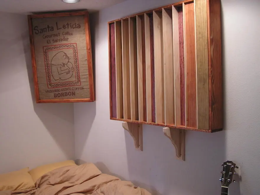

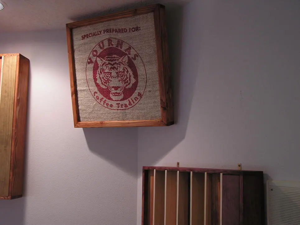

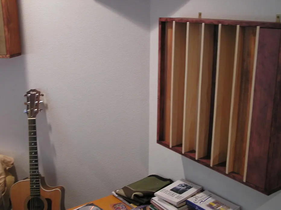

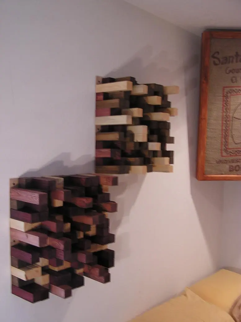

OK I'll try to post some pictures, but here's some websites that will tell you how to build QRD diffusors if you are interested. I've made some 1-D diffusors also called Schroeder diffusors, and some 2-D diffusors also called skyline diffusors. There's some of each in the pictures as well as the base traps.
Here's the link for the 1-D. Just type in the depth and the width and the site computes all the depths of each well.
http://www.mhsoft.nl/diffusor.asp#calcul
Here's the link for the skyline diffusors:
http://www.pmerecords.com/Diffusor.cfm
Here's some pictures:

Only 4 pics allowed per post, so here's the skyline diffusors as well as an attemp to show how these were hung with chains and one hook.
Best of luck to you
