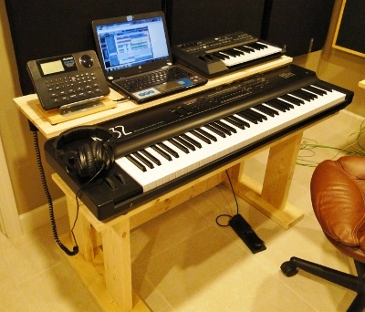

Here is a photo of the Homestudioguy.com DIY Keyboard Stand I just finished Designing and Building this afternoon. I am almost finished with the Optional Music Stand for it as well.
Front Keyboard Shelf puts my Workstation "Keys" about the same height of Standard Piano "Keys".
I just need to complete some last minute DIY BUILD PLAN updates then off to the Copyright Office they go for that "Gimme Yo Numba".
Cost to build it will be about $30-$35!
:thumbs up:

1. Wouldn't it be better to "design" it to take a full size keyboard. That thing you've got on it doesn't have 88 keys from my counting?
2. You're going to copyright a plan to build a wooden desk? Apart from the height of the front bench, which I assume you've dropped a touch, how does this differ from your bog standard 2 level computer desk?
3. What if you don't have a laptop? Where's your PC? On the floor getting dusty? Cradle?
4. Wouldn't having any reasonable size monitor that people are actually going to have these days (min 22", probably bigger), centred on the top shelf, disallow the possibility of putting any useful gadget either to the left or the right of the monitor?
5. How do I operate the laptop, assuming you've convinced me of the need to have one rather than a PC. Where's the place I put (at least) my mouse? Not to mention external keyboard..
Or have I misunderstood its purpose?
So, I'm curious, but...
5. How do I operate the laptop, assuming you've convinced me of the need to have one rather than a PC. Where's the place I put (at least) my mouse? Not to mention external keyboard..Or have I misunderstood its purpose?
1) My DIY Build Plans for the Keyboard Desk explain that for wider keyboards, you can use the same Base Support structure and increase the length of the Keyboard Shelves as needed.
2) Copyright? My current DIY Build Plans have sold across the U.S. and in 20 countries around the world. It's nice to have the Copyright Protection.
3, 4 and 5) This unit is not meant to be a full-fledged Recording Studio Desk/Workstation, although, in a pinch by adding a pair of Audio Monitor Stands, it might work, especially if you are hard-pressed for cash.

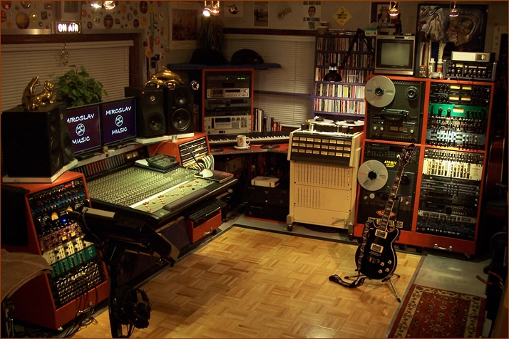

Heck, I built my own racks, console desk and wrap-around furniture...and I don't think it's anything unique...there's already a million of these kinds of things out there.
The orange colored racks/furniture in the pic is what I built....the console piece and side racks is a single unit on wheels.

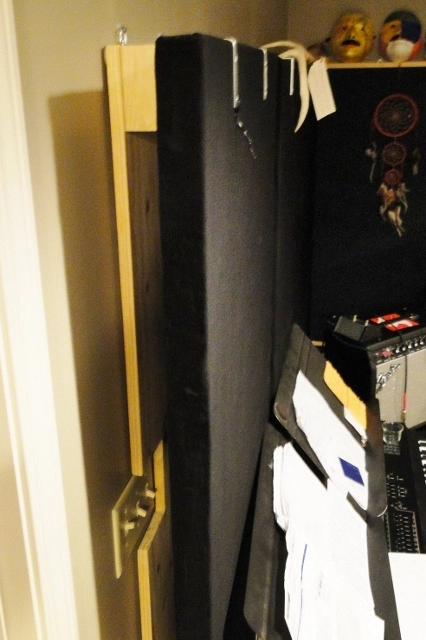

Oh...explain some more about your bass trap back panel. I've not seen anyone do that....is that something you just added on instinct, or is there some kind of "math" behind it?
Is the panel also attached to the wall or is it free standing? It looks like it's hanging from a hook.....???

In regards to the Acoustic Panel Mounting Unit, there is math and etc to back it up.
My initial concept came from reading acoustics information written by Ethan Winer.
The first "aha!" came when he wrote about the fact that placing acoustic panels away from the wall increases bass absorption and if I remember correctly (its been a LONG time since I read this info), max distance would be 1 foot.
Secondly, he discussed the issue of people building wooden frames around their OC-703 etc panels and how that actually reduces the panels absorption capacity, and if I remember correctly (its been a LONG time since I read this info) by as much as 33%.
Thus the concept for my idea!
As an FYI, it has received the "blessings" from Ethan, GIK Acoustics and ATS Acoustics.
In fact, ATS Acoustics featured it on their website in their DIY section for years.
