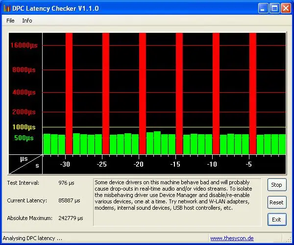

The audio and video on my new computer had serious pops, clicks, jerks, stops, hesitations. Running DPC Latency Checker (http://www.thesycon.de/deu/latency_check.shtml) it was showing spikes at 80, 90, and100 THOUSAND milliseconds (us) spiking WAY into the red every 1-3 seconds! I've disabled/enabled drivers and uninstalled/reinstalled programs to try and isolate the problem and, after finding a tip on a forum, uninstalled EasyTune (a Gigabyte piece of software); some improvement, but still far from right.
Attached is an image of DPC running a few minutes after I fire up. Lows are in the 600 us, spikes are in the 80,000s. (Yikes...) It runs like this for a long time and, weirdly, inexplicably, with no discernible pattern, the red spikes end, but the green stays in the 600-700, obviously not right.

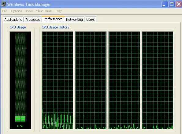

Also attached is an image showing CPU Usage.
Obviously... something...is spiking every 5 seconds on the beat.

CPU spikes are normal during audio playback because the machine needs to read data from the drive every few seconds. Although a USB drive will make that far worse.

Thanks for your time and input, BushmasterM4. Disabling network adapter devices and rebooting seem to do nothing to the DPC graphs. Same exact latency issues.
Yup. However, the spikes occur with the computer in idle, Firepod off, no sound, no video. Take a look at the DPC image I attached. Clearly not normal.
