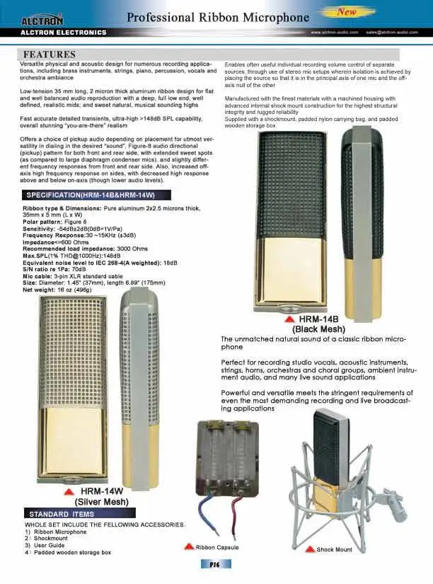

This one has a dual ribbon. I wonder how long before we see the Nady and, possibly, Shinybox incarnations.
Thats made by Chinese Alctron, the maker of Nady and other "China" ribbons.

I'd be interested in hearing what you think. Double ribbon mics are rarer than single ribbons, the two most common being the Beyer M160 and M130, both of which are substantially more expensive than the Alctron (although not as expensive as other ribbons like Royer, Coles or AEA).

...the explanation for the purpose of a double ribbon element is likened to using a large diaphragm in a condenser mic...improved frequency response, and improved clarity (of course the circuitry would have to be capable of taking advantage of additional ribbon response)...when the 2 ribbons are aligned side-by-side (as in this particular design) it should enhance the mics ability to capture a single source (voice or instrument)...
...other dual-ribbon designs place the ribbons at different angles inside the mic to enhance stereo imaging and create a broader soundfield...
...my intended use is as a vocal mic, so I'm very interested in testing this product...
...I have received my mic from Stellar (same as the Alctron Nickel/Gold version pictured above) and I would like to make some first impression remarks...first of all, the fit and finish of the microphone is impressive...nothing cheap or chincy on this mic...compact, solidly constructed and weighty...no rough edges...very nicely finished...and the wooden storage box and shockmount are equally impressive...if I did not know the origin of the mic, I would easily assume it cost considerably more than I paid...I would venture to guess, no one will be disappointed by this purchase...
...I only plugged it in briefly to make sure it was working properly, and it has a very nice, smooth response (voice dialog only thus far)...not at all dull like some ribbon mics at this pricepoint...I am anxious to try it on vocals...I am awaiting the arrival of a new mic-pre with substantial gain (about 80dB) at which time I will record tracks for posting...
...one other thing...the shockmount included with my mic had a faulty hinge...I contacted Peter Bloch (Stellar Microphones) and sent him a picture of the mount's problem...he immediately shipped a replacement mount out to me...here's where the issue of customer service enters into the price equation...in my particular circumstance, and because the shockmount is specific to this mic's application, the extra cost I incurred by purchasing from a distributor rather than a group buy, became money well spent...there's a reason Stellar has 100% positive feedback on eBay...much thanks to Peter B... :D

Both Beyers are completely different animals. The ribbons are actually in front of each other, unlike side-by-side RM4. There are two reasons for that:
1) Since the ribbons are in parallel (unlike in series in RM4) the combined ribbon impedance is lower and gives lower noise figure.
2) The second ribbon (right behind the front one) creates time delay--shifting pressure gradient it improves HF response.
The kind of arrangement used in RM4 was used in some commercial mics. From top of my head I can remember Oktava ML52-02 and more obscure vintage Geloso double ribbon.

Yeah, it looks like a typical commercial/marketing explanation from website. There is no even one word of truth in all this BS. It seems they don't understand themselves about advantages and processes involved. Sad.
