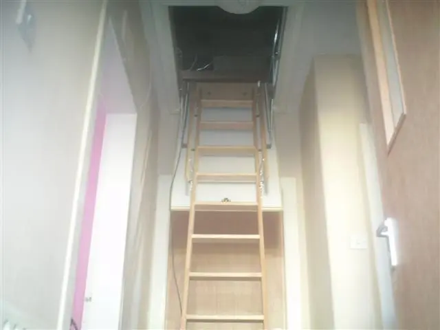

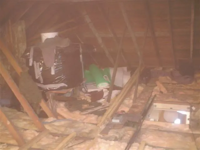

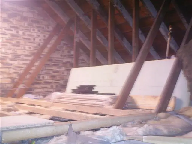

ok here's some pics
the hatch
the view from the skylight
angled recess mix position in control room
angled recess couch position in control room

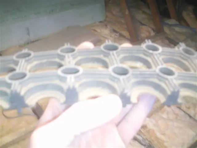

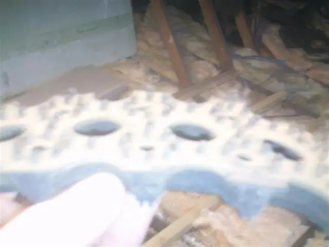

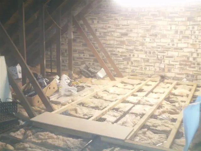

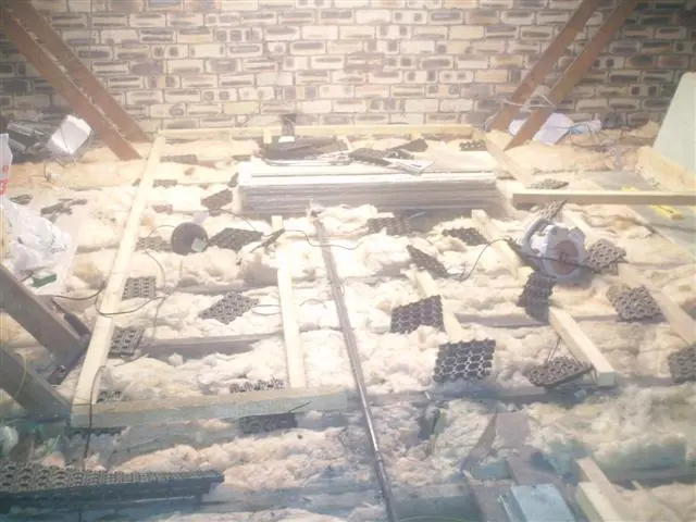

my neoprane substitute rubber safety fall from kids play areas
..tried and tested in the last studio

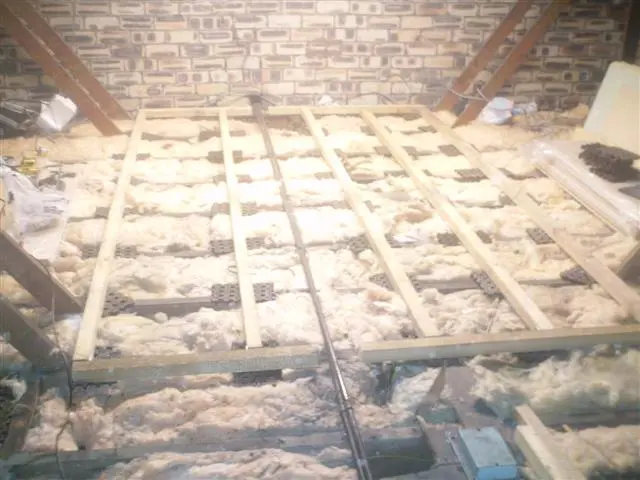

framework cut and layed out
Framework bolted up and floating
tomorrow I'll get the RW45 rigid in there and cover with tongued floor pannels.... oh after I extend the frame into the two recesses, damn! lol

so the control room will be 13' between the mix position recess and the couch position recess and 10' wide from the brick wall to the wall I haven't built yet. Drums will go on the brick wall...new wall will have door and maybe a window..I have the glass from the last build.

Did you says 2x6 floor joists? What is the spacing? That dimension of joist is ok for holding up a ceiling, but not a floor!! Here US stateside second floor joist for residentail are more like 2x10 or 2x12 on 16" centers. My studio is on the second level above a garage, but has 16 inch deep trusses on 16 inch centers.
I would think you would get a lot of deflection and possible joist failure with where your at unless there are a lot of supporting walls underneath.
Even thenm I would not do this.
Sorry, the floor joists up there are 2x8 on 14" centres and there's a double brick supporting wall running up the centre underneath, so the longest span is 12.5 feet unsupported but as the control room will be staggered across the supporting wall it reaches 6.5 feet on either side of the supporting wall. I've had it checked out and it's all good to go.
