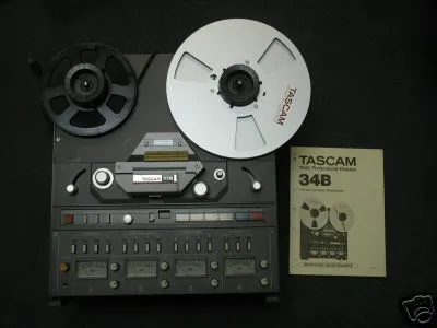

Well I've finally made the plunge into Analog Land at the bottom of the boards here. Decided to get a Tascam 34B, 1/4" 4-track.
While doing searches on tape I see there haven't really been any discussions on the different brands of tape, only talks on the fidelity gained by less tracks on wider tape. Does anyone have a firm understanding on what's gained by using one type of 1/4" tape over another. Quantegy has a 600 series, 499, 456, 467, 406/407 etc...,
I've also noticed that they seem to be the only american distributer left since they re-opened their doors. Anyone else sell tape on this side of the ocean yet?

I agree since your machine is probably set up for 456 or 406 I would keep it simple and get some of that. And if you have that tape on your machine that is in the pic I am guessing that is 601 or 603? maybe,
Anyway I would be putting it in the trash and get some new 456 and not look back.
And congrats on getting a super machine that will sound great.
