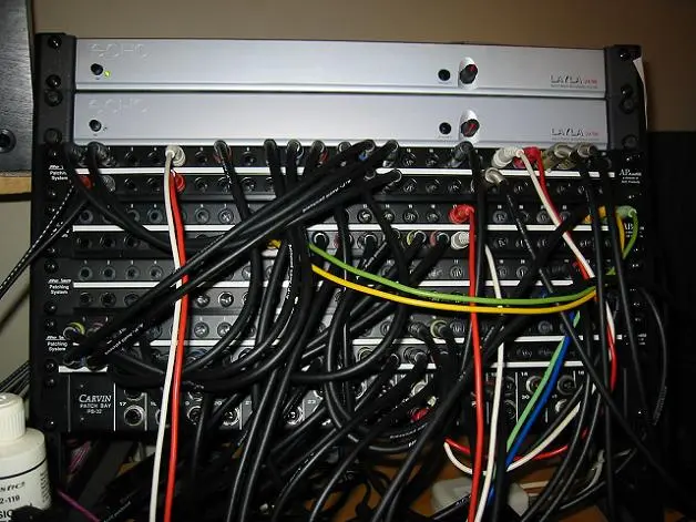

I have the first 16 on each bay normaled with the pres to the converters on one, then the converter to the board on the other. The other 8 on each bay is isolated for my effects and stuff.
Patchbays are very handy. May yours one day look like this!
